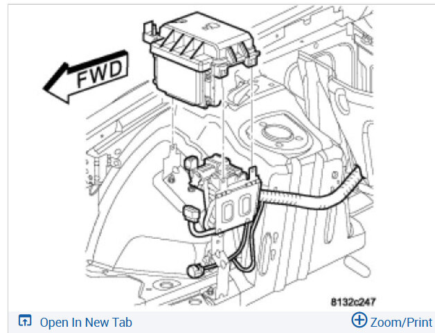

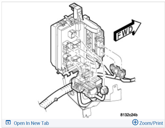

Sure, I can help, if would be better if I have a short video to look at of what the car is doing, you can upload it here in your response. I would start by making sure the battery is good and the connections at the battery are clean and secure as well, this guide can help:
If this is not the problem I have seen the wiring less ignition node or the TIPM, I see the TIPM powers the data link connector so I would start there, please check the wht/lt blu wire at the data link connector for power this guide can help (key on).
If there is no power replace the TIPM which is easy because it-self learns so there is no programming. Here is the location and a video to help with the data link issue.
https://www.youtube.com/watch?v=6Tlg3JmgNSQ
You can get a used TIPM from eBay FYI. Check out the images (below). Please let us know what happens.

I replaced the tipm and nothing still the danger and the lights and cluster lights on dash can't all the way on after needing with it for some time and then back off but that's why I'm thinking it's a wiring unless you stairs battery first that's fine then I'm also looking out where is my back located cus I've been told it might be that's however and another states it's probably the time and we have replaced that and so will use needing a new reprogram the key make it so the dash lights and all that stop I didn't think that would please help how do I test what or where should I start cus I can't driver it anywhere without it starting even in an emergency like how I'm needing it now

Hmm,, usually the TIPM will fix it. At this point we need to do a CAN scan to see what codes are present, can I ask if the car has had water damage? The TIPM does not need programming, it self learns. In the video, when the lights go out are you trying to start the engine when this happens? Can you please upload an image of you battery and terminals?

The BCM is the TIPM so no worries there, can you upload an image of the battery cable ends please?
