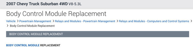

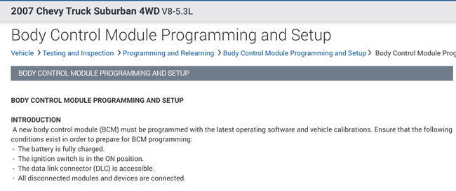

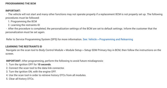

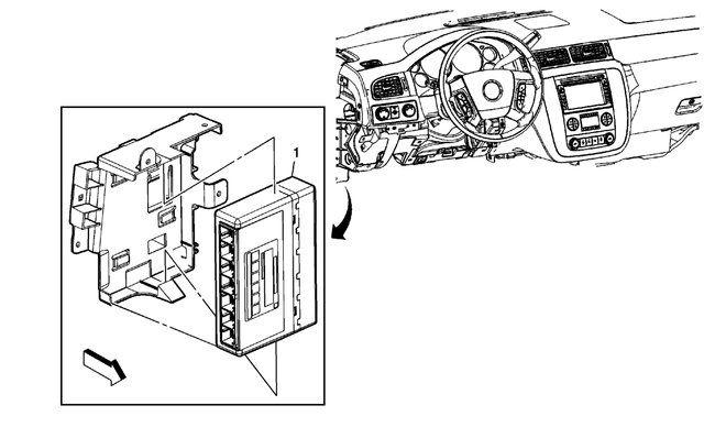

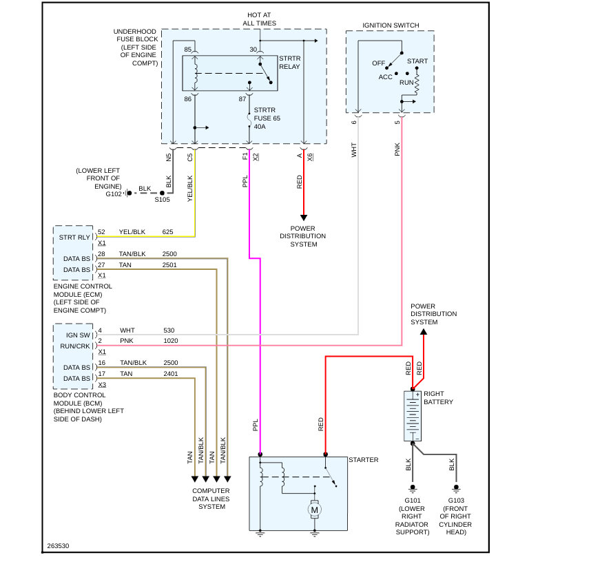

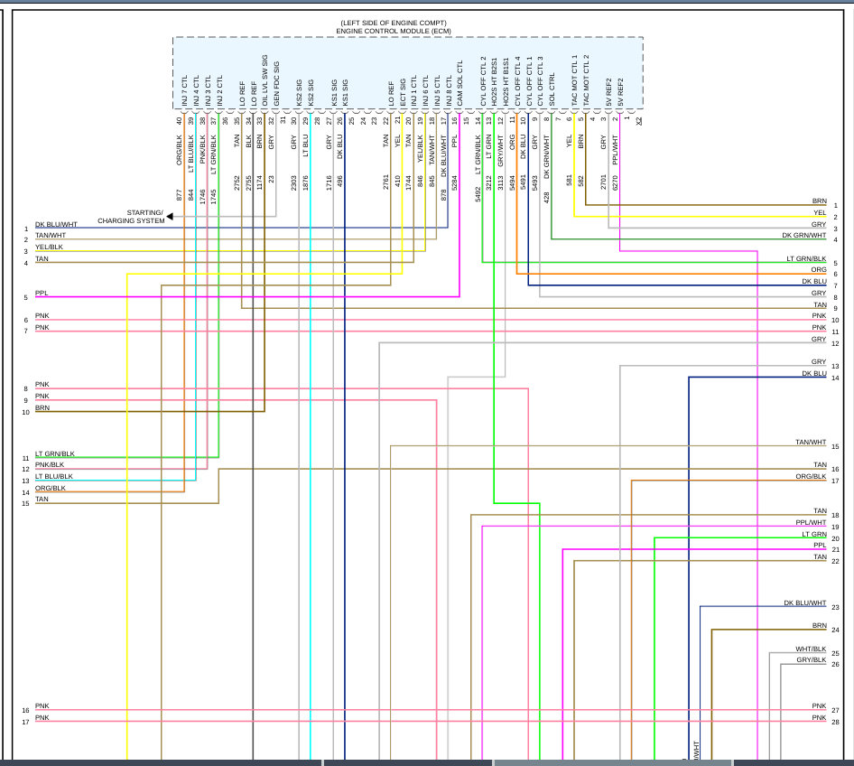

Car was running pulled in driveway shut off. now no start, has no signal to the starter, good battery and connections all engine and body grounds good. was told it could be the BCM. would that ruin the start circuit?
Feb 24, 2020 at 10:54 PM
SCGRANTURISMO
  • CAR REPAIR CONTRIBUTOR
  • 4,897 POSTS

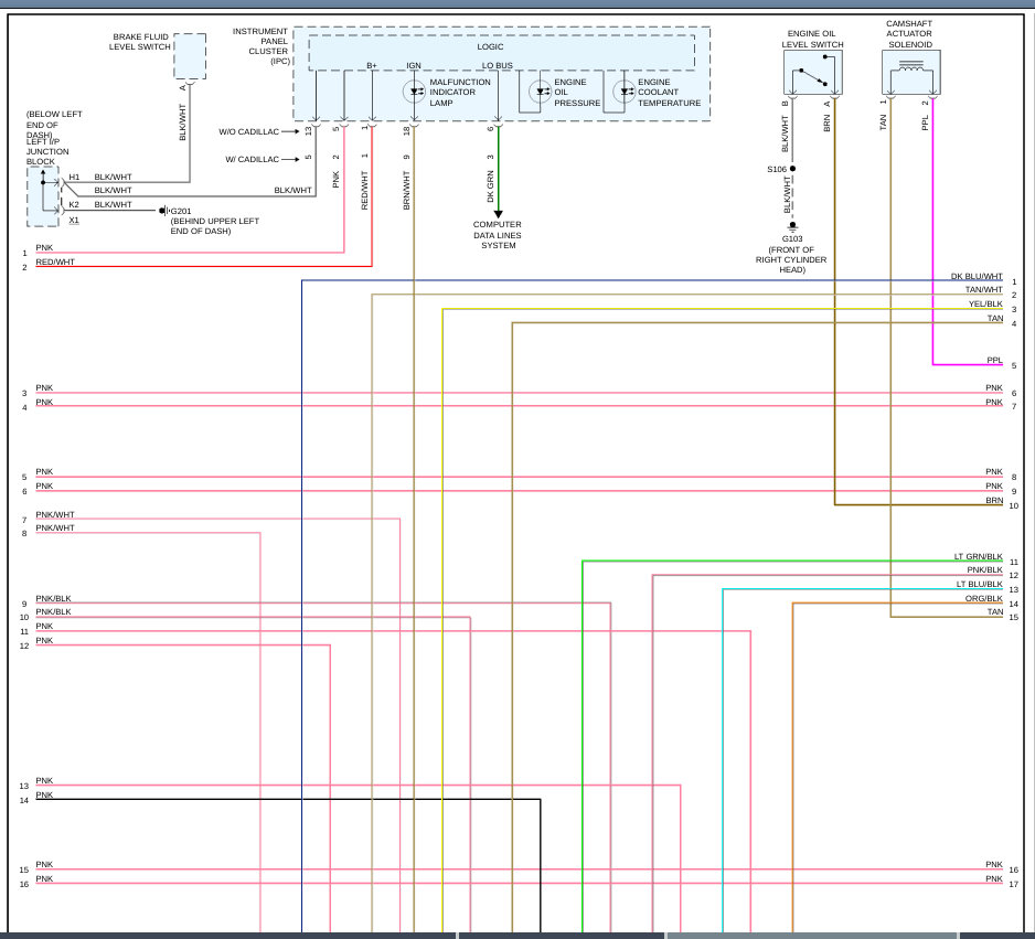

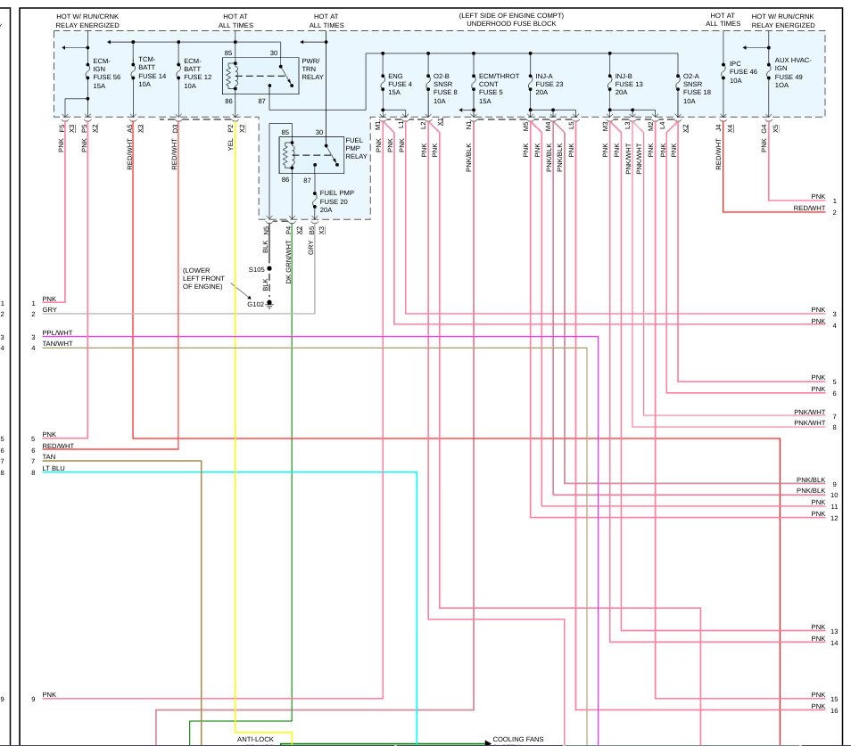

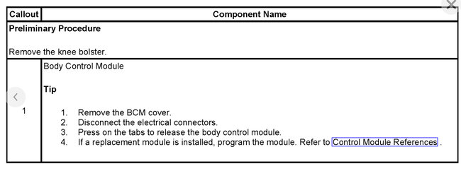

Yes, it could. In the diagrams down below I have included the starting circuit wiring diagram for your vehicle. As you can see on the wiring diagram both of the wires coming from your ignition switch go to the BCM. I have also included instructions from the vehicle manufacturer for the removal, installation, and programming of your vehicle's BCM. Please go through these guides and get back to us with what you find out.

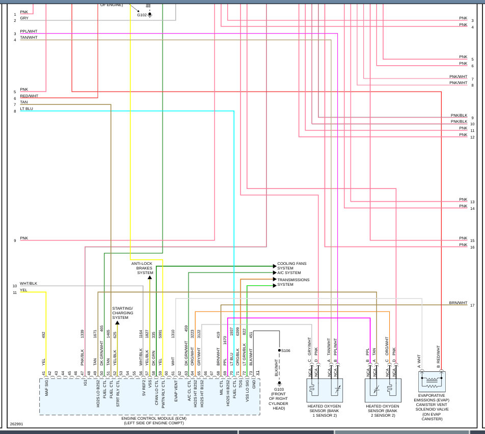

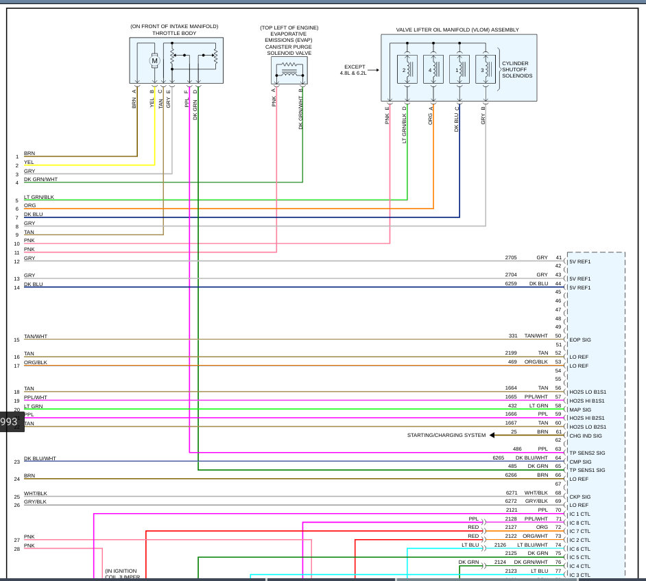

SCGRANTURISMO
  • 4,897 POSTS
Hello again,

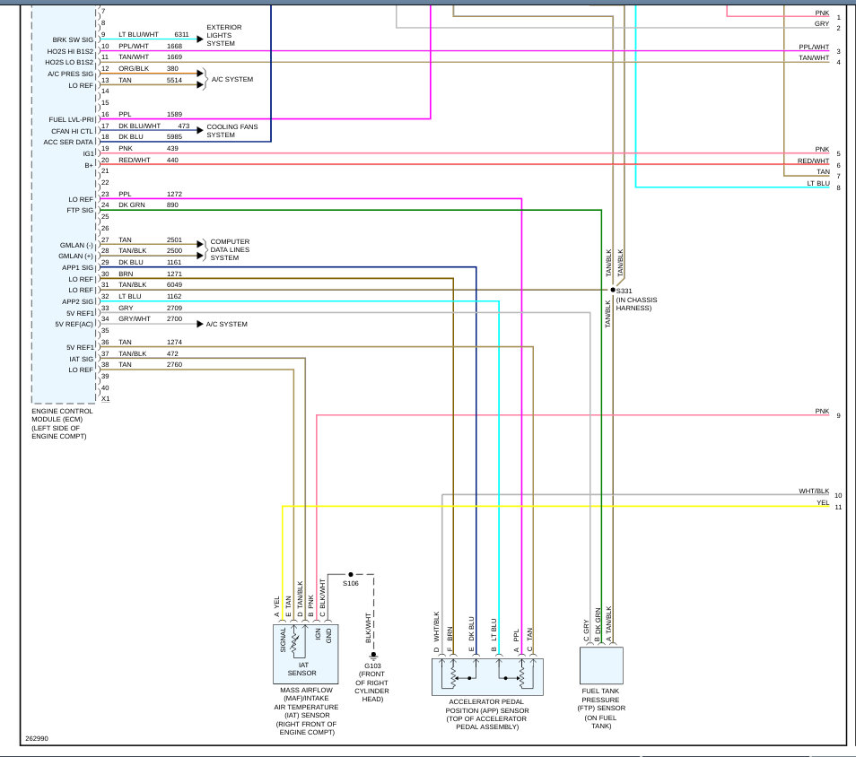

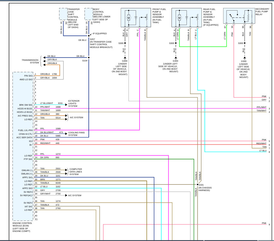

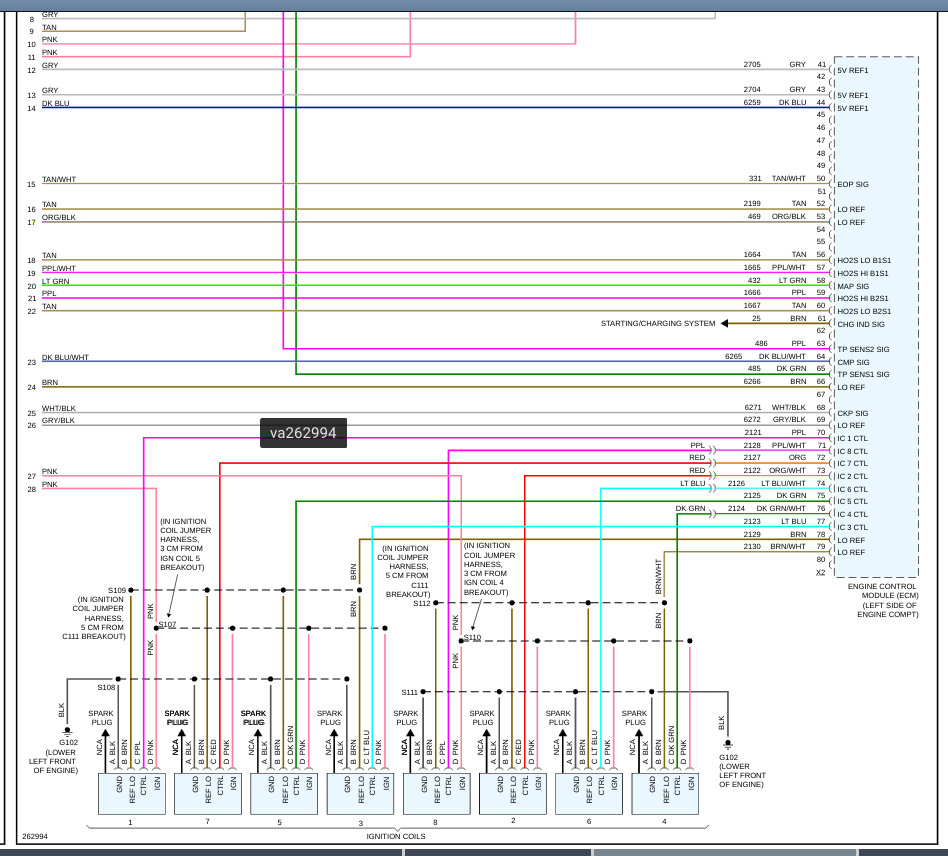

Here are the Powertrain Management wiring diagrams for your vehicle. I hope that these help.
