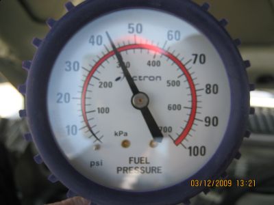

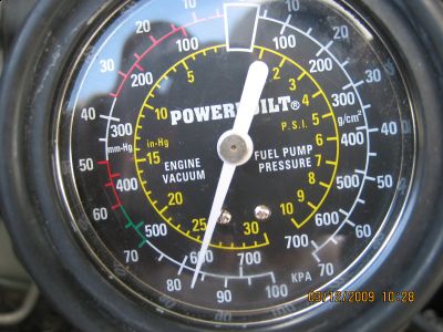

Dear Rasmataz, Yes you're correct.The repair manual says: 34 psi at idle and 43 psi when switching the vehicle a few seconds after the ignition switch is turned OFF then ON. Here are my findings at idle(rough of course, but slightly better).Can you examine the photo with the pressure on it and tell me what you think? Maybe you can make sense of it. I also performed a fuel pressure regulator test(per the manual). It reads: Start engine and read the indication of fuel pressure gauge as vacuum is changed. Fuel pressure should DECREASE as vacuum INCREASES. If results are unsatisfactory, replace fuel pressure regulator. Now my engine was surging at times during this test which should have made the vacuum signal stronger at one point as rpm's increased but it did not move from the word 'zero' on the hand pump gauge. Now I have a MityVac hand pump with the hose connected to the regulator with the hose plugged and at NO time did the vacuum gauge from the MityVac change. The fuel pressure did not move at any time either.

The pressure gauge you got can only measure between 0-10psi get a higher calibrated pressure gauge.
NOTE: When you decrease vacuum to the pressure regulator the fuel pressure should rise about 8-10psi

Dear Rasmataz, I've attached a photo of the reading for the fuel pressure. I love this gauge!!! So easy to use and accurate.
https://images.2carpros.com/forum/automotive_pictures/316478_IMG_1449_1.jpg
The pressure only read at 43 psi and never 34 psi at idle like it states in the manual. Do I pull the vacuum line off of the fuel reg. to get the pressure to go down to 34 psi.? The injectors all read 8.5 ohms across the terminals(10-14 ohms @ 77*F is the spec.) All harnesses have battery voltage present and all injectors make the 'clicking' sound as the solenoid pulses on/off. So no problems there. Any other thoughts? Thank You!!!

My engine starts up fine but the idle is very rough and the engine stalls. Did you check the EGR and PCV valves to include the TPS
Pressure gauge looks pretty-Okay when you remove the vacuum line from the pressure regulator the fuel pressure should increase and when vacuum hose is connected this is where the regulator should regulate 34 psi-In the event the pressure is still high while vacuum hose is connected -check the fuel return line if its clogged up-blow thru it with compress air. No clog replace the regulator
Mar 12, 2009 at 6:54 PM
