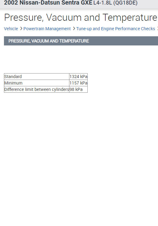

You can have low compression for few different reasons. The most common one is faulty piston rings.
First you need to confirm the compression number for the cylinders.
This engine should have minimum of 168 PSI of compression. With the highest to lowest cylinder should not have a variance more than 14 PSI. So if the highest cylinder is at 180, the lowest one should not be less than 166.

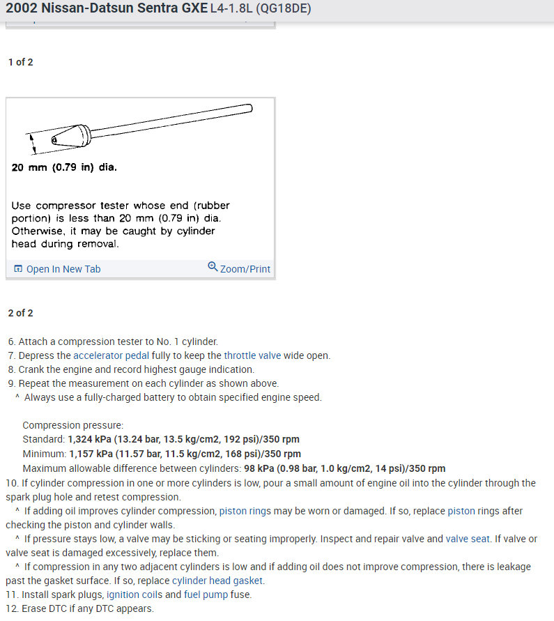

There are a few things that can cause low engine compression. For example, a bad head gasket, worn rings, and leaky valves. What you need to do is perform a couple checks to see what the cause may be.
To start, take a look through this link. It explains in detail the things I mentioned.
https://www.2carpros.com/articles/the-reasons-for-low-compression
Now, the first thing to check for is a bad head gasket. Take a look through this link:
If that all checks out good, then we need to determine if it is a piston ring issue or a valve issue.

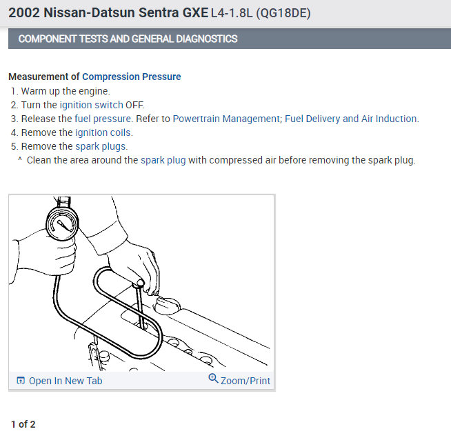

Next, follow this link to perform a compression test. While doing it, write down the compression found in each cylinder.
When you finish, take approximately 1 tablespoon of motor oil and place it in one cylinder at a time. This is called a wet compression test. Retake the compression of that cylinder and write down the results. Continue this with each of the remaining cylinders.
Here is what you need to focus on. If the compression has substantially increased under the wet test, the rings are likely worn and need to be replaced. If there is no chance, then you likely have an issue with the intake/exhaust valves in the cylinder head.
