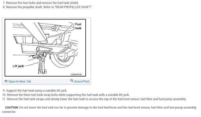

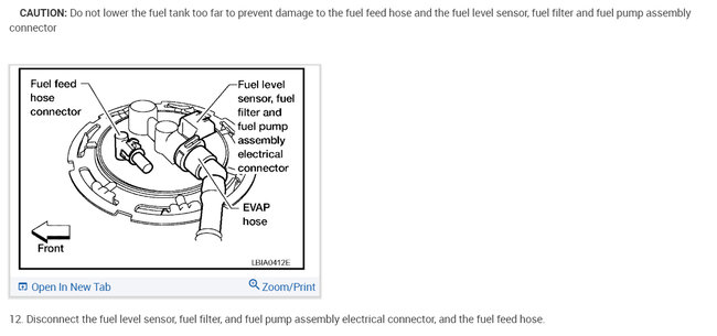

I believe it is the fuel filter after driving my car and I come to a stop once I press on the gas my car is slow to go and there is even resistance. The service engine soon light is on. My car smells like burnt rubber.

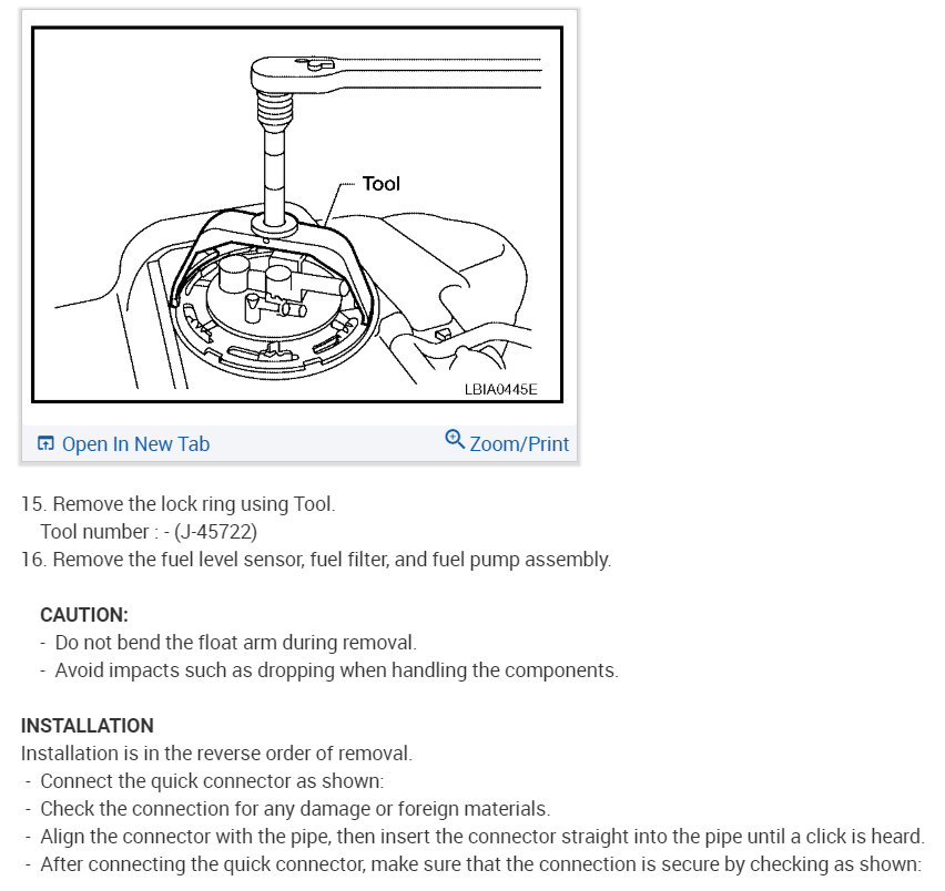

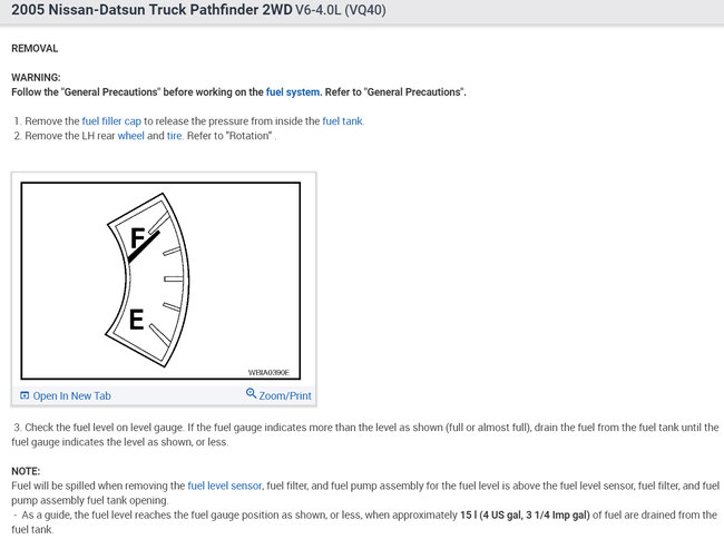

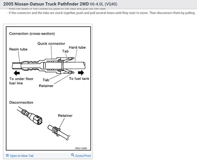

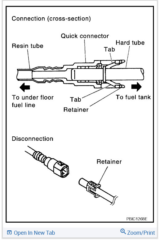

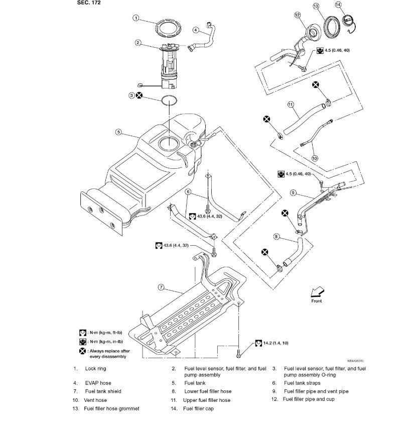

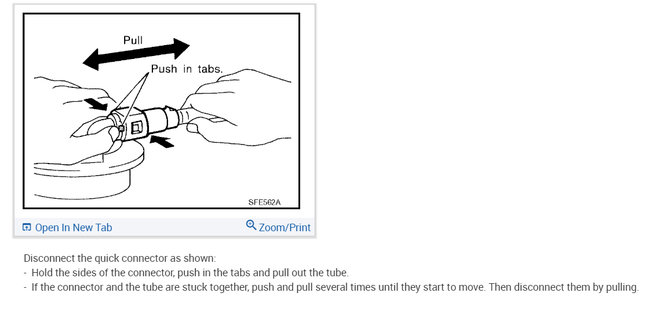

The fuel filter is in the tank here is a guide to help you see what you are in for when doing the job and how to to the job on your car below.
https://www.2carpros.com/articles/how-to-replace-an-electric-fuel-pump
We should run the codes as well.
Just to see what comes up.
