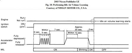

70000 I just put on a new automatic thorrth control and I am getting a code of p0507 idle control systemrpm higher then expected how do I adjust?

1 . Start engine and warm to normal operating temperature.
2 . Ensure all conditions under PRE-CONDITIONING are met.
3 . Turn ignition off and wait at least 10 seconds.
4 . Confirm that accelerator pedal is fully released, turn ignition on and wait 3 seconds.
5 . Repeat the following procedure quickly five times within 5 seconds: Fully depress the accelerator pedal. Fully release the accelerator pedal.
http://www.2carpros.com/forum/automotive_pictures/192750_IdleLearning03PathfinderFig18_1.jpg
6 . Wait 7 seconds, fully depress the accelerator pedal and keep it depressed for about 20 seconds until the MIL stops blinking and turns ON.
7 . Fully release the accelerator pedal within 3 seconds after the MIL turns ON.
8 . Start engine and let it idle.
9 . Wait 20 seconds.
10 . Rev up engine 2 or 3 times and ensure that idle speed and ignition timing are within specifications. M/T and A/T in Park or Neutral: Idle speed: 700 - 800 RPM, ignition timing: 10 -20 BTDC.
11 . If idle speed and timing is not as specified, Idle Air Volume Learning will not be complete. In this case, find the cause of the incident. Proceed as follows:
