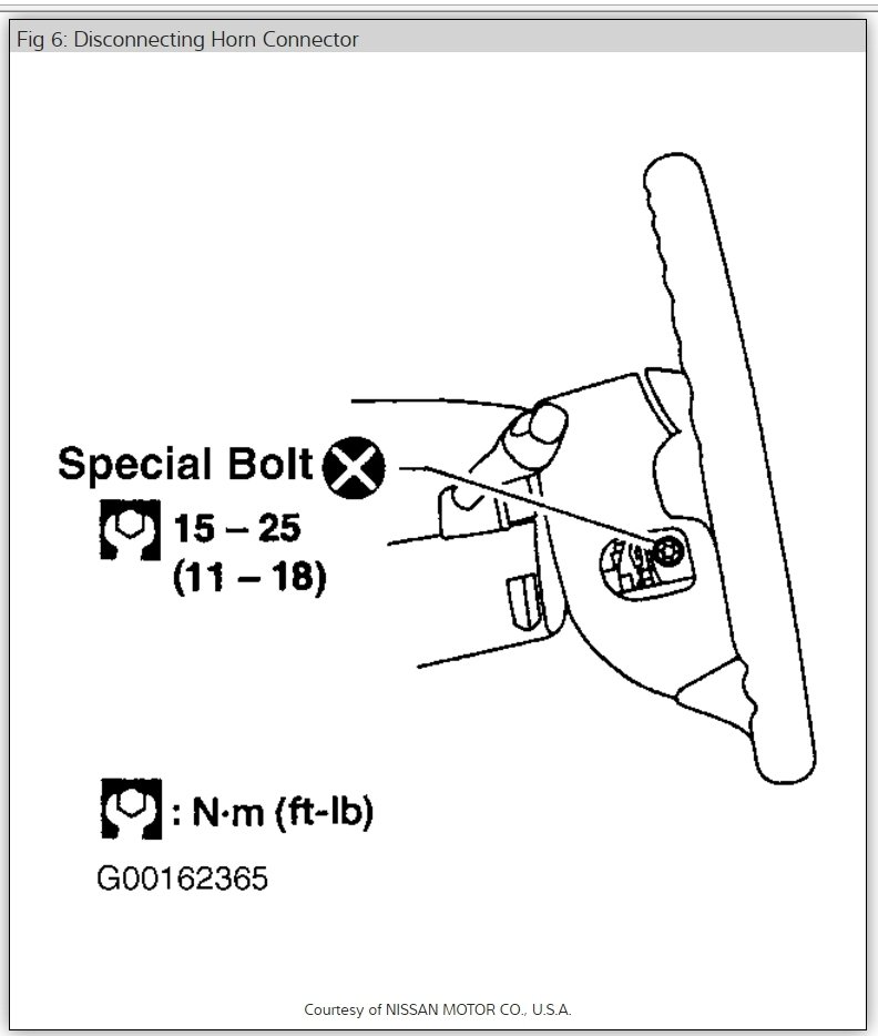

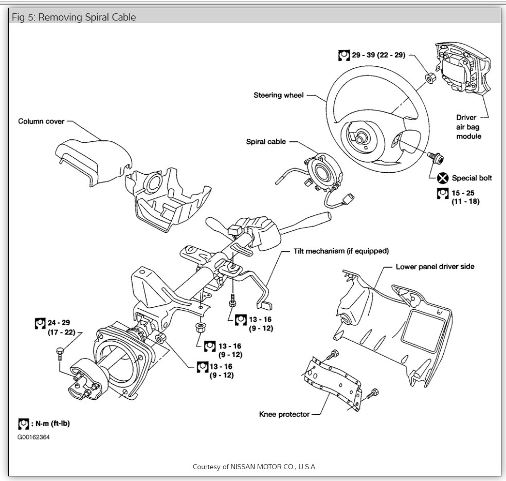

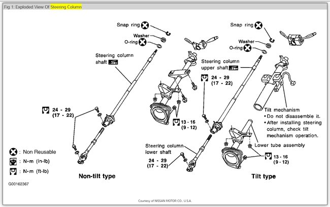

This problem occurs when the ignition lock is worn out and needs to be replaced. You can get one from Amazon or the dealer.
Here is a guide on how to do it.

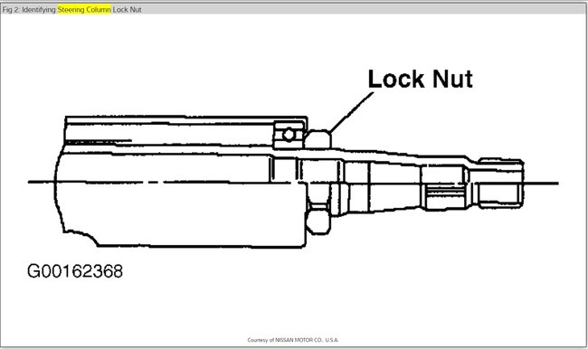

When disassembling and assembling, unlock steering lock with key.
Install lock nut on steering column shaft and tighten the nut to 18-25 ft. lbs. (25-34 N.m). See Fig 1 and
Fig 2: Identifying Steering Column Lock Nut

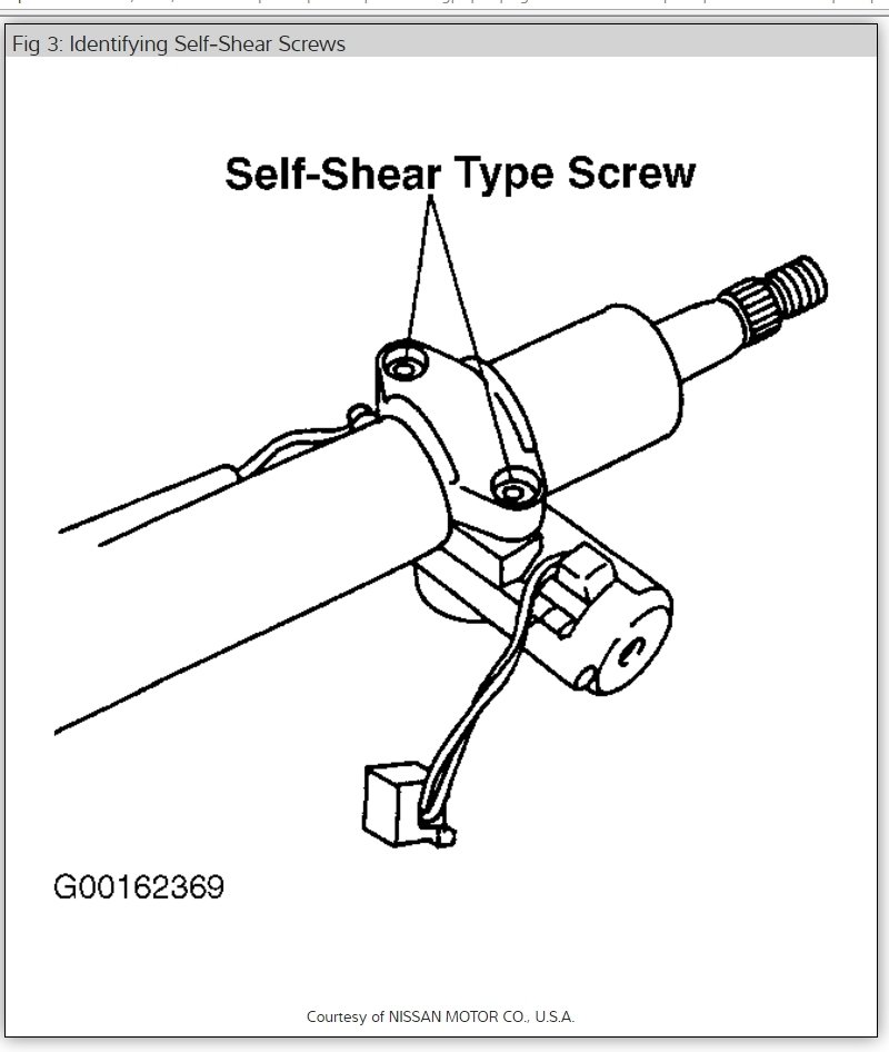

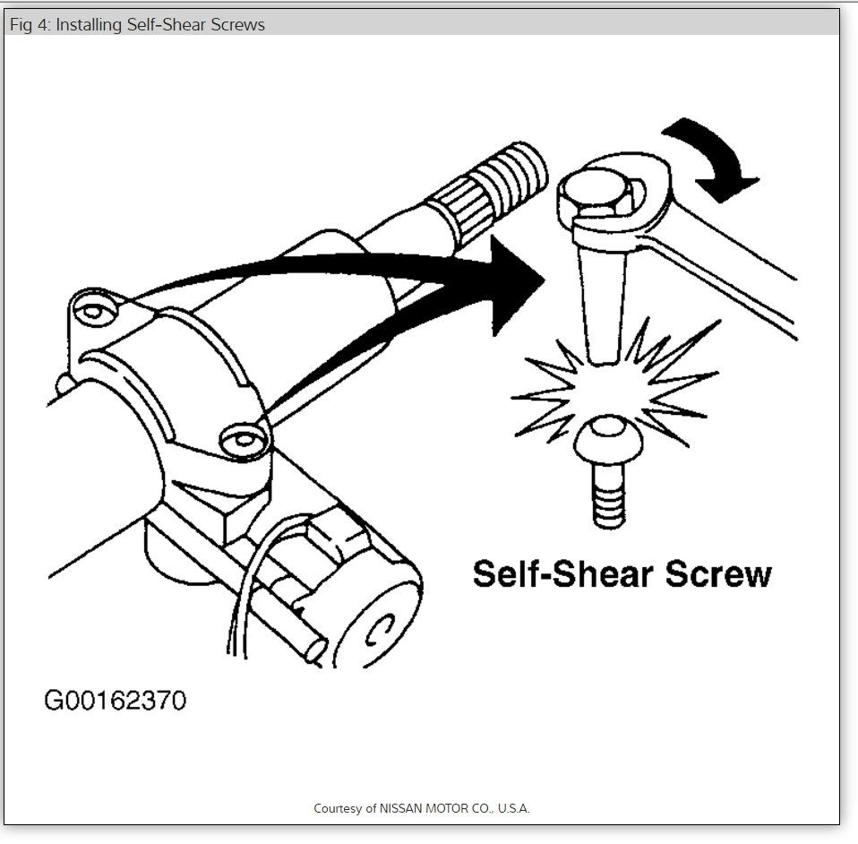

When removing the steering lock, break self-shear type screws using a drill or other appropriate tool.
When installing the steering lock use self-shear type screws. Tighten until heads break off. See Fig 4 .
After installing steering column, check tilt mechanism operation.
These bolts that hold the ignition switch you will need the chisel or drill out to remove, kind of a pain but stick with it and you can make it happen.
Here are some guides below to help.
Please let us know happens so it will help others.
Best, Ken
