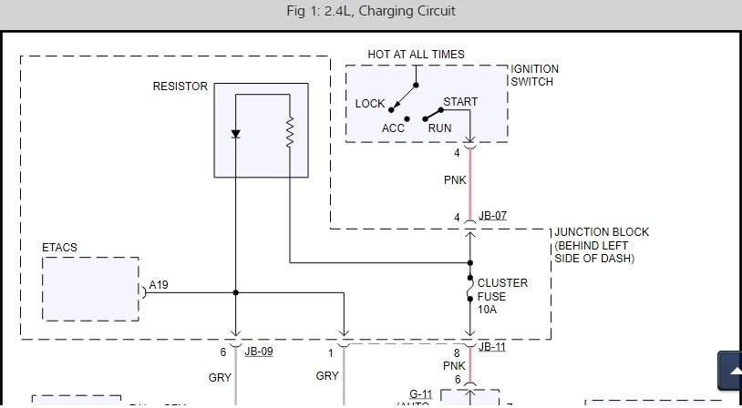

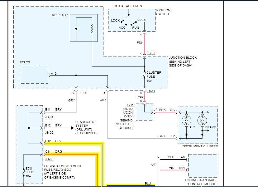

I have traced the orange and white wires to their respective sources and discovered no failures. So I am asking for the complete wiring diagram so that I can trace the gray wire in the diagram to its source because I suspect that the failure is in that side of the circuit. Thanks

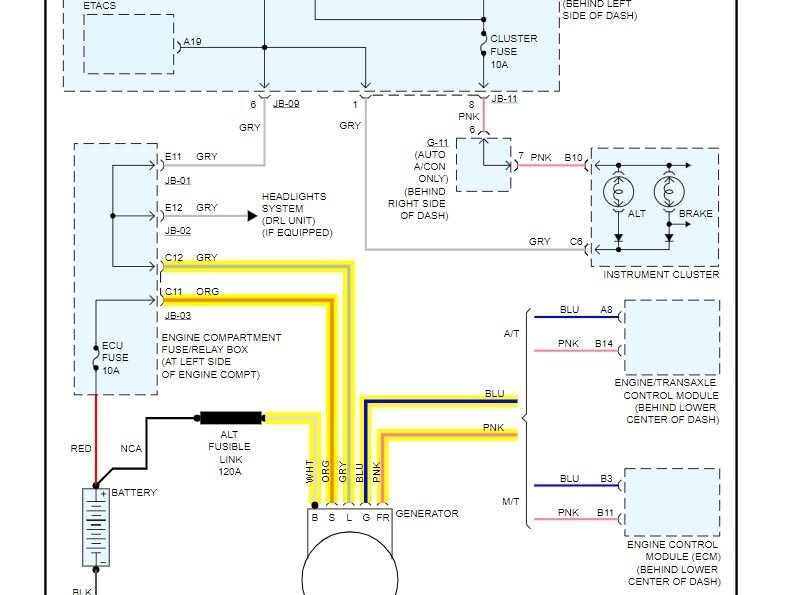

Good afternoon,
You should have 2 powers that are constant. The orange and the White wires should have battery voltage.
The gray should have power with the key on. That controls the light.

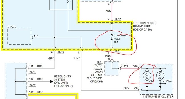

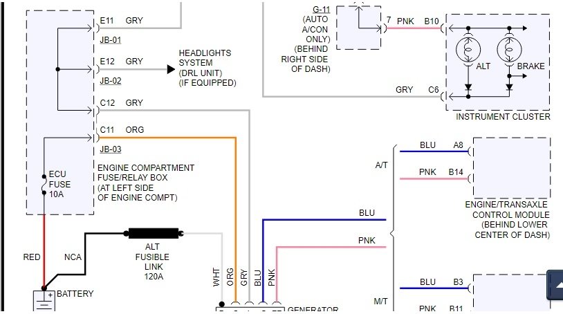

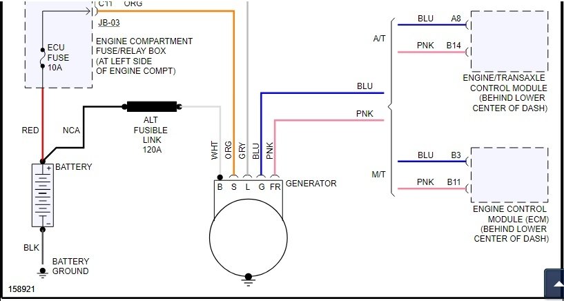

I looked up your vehicle's system wiring diagrams in Prodemand.
I am unable to copy (or cannot figure out) how to copy from this pay-online vehicle manual. I have been "screen-shoting" from it for years now. This may be the only way to do it.
It took three screenshots to get your "charging system" diagram and large enough to be legible.
I always try to overlap my shots so that nothing is missing. The 1st three are the top/ middle/ bottom.

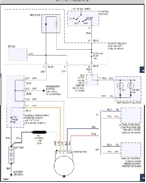

Printing the shots and taping them together may make things more understandable.
With a little time on my hands, I pasted my 3 shots on a large white background in "paint", I had to resize them and a few other operations.
Pic 4 is my "Frankenstein" attempt to reassemble the shots. It is crappy! You may want to disregard it completely! (Sorry!)
