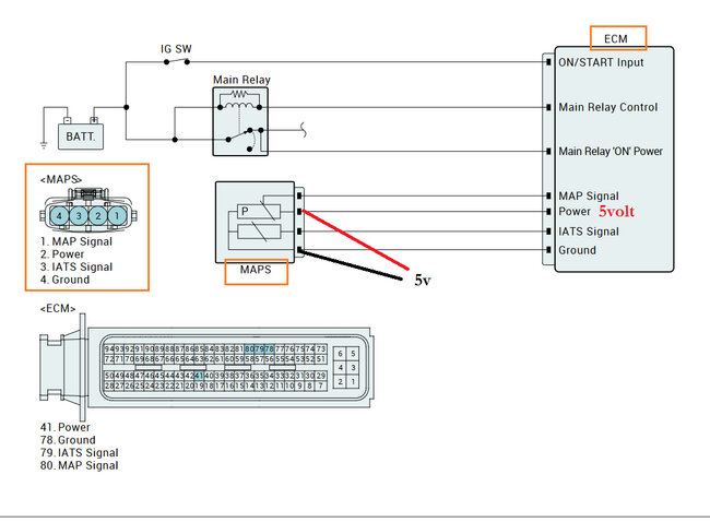

Hello, the codes setting, p0108 and p0113 are both related, I'll post a wiring diagram for you, but the cylinder 2 misfire code may not be related, where did you buy your parts from when trying to get rid of this misfire?
May 11, 2024 at 11:09 AM
AL514
  • CAR REPAIR CONTRIBUTOR
  • 5,502 POSTS
Is your check engine light blinking when it sets the misfire code? The other 2 codes are for the MAP sensor and intake air temp sensor which are combined into one sensor, so the sensor may have a bad ground, since the MAP sensor part is indicating a "Signal High" and the IAT part of the sensor is indicating a "Signal Low".
This is the OEM for the MAP/IAT sensor, with it unplugged, key On, engine Off. You should read 5volts across pins 2 and 4 with a multimeter set on DC volts. Thats the first check I would do.

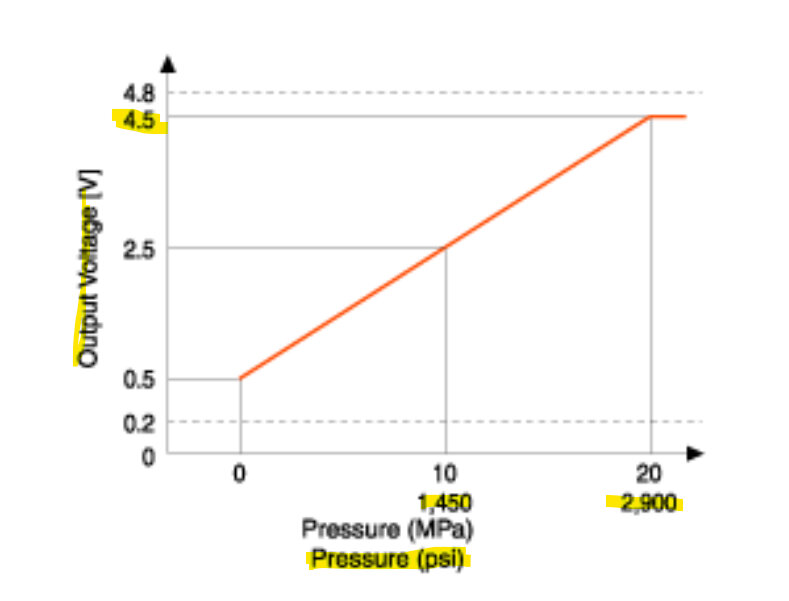

If you think a fuel injector is stuck open, pull up live engine data on your scan tool, and monitor the Fuel Rail Pressure data PID, it has to have one, this being a GDI system. If you can graph that data PID it would be best, then shut the vehicle off but turn the key back on, engine off so you can still see the live data and watch for the Fuel Rail pressure to drop off fast. that's a sign an injector is staying open mechanically. Now if the injector driver in the PCM is burned, and the injector control is constantly grounded, the injector will stay on constantly but only when the engine is running.

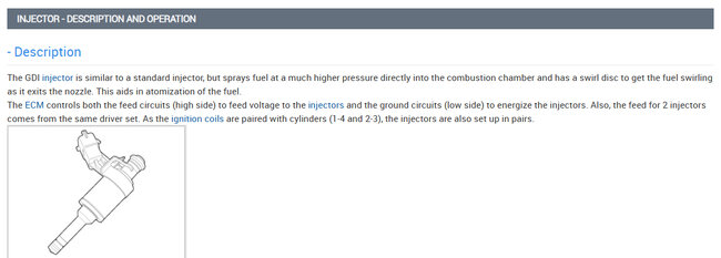

Here is the GDI injector operations diagram, you'll notice it states "Also the feed for 2 injectors comes from the same driver set" So power for the high side powers up 2 injectors, and most GDI injectors are Peak and Hold type, meaning they open the injector with a high voltage, and then pulse them with a lower voltage to keep them open. But you should be able to see the Fuel Rail data PID drop off quickly if one is staying open, check that first. Since you can't tap into these fuel rails due to the very high pressure, watching the data PID should help you figure out what's going on, a ton of white smoke sounds like one is staying open. The resistance spec for each injector is 1.5 Ohms. I'm looking for a fuel pressure spec, but it will be high, usually 500 to 2000psi for a GDI rail.

Are the MAP sensor codes coming back? Also look for the Long-Term and Short-Term Fuel Trims, (LTFT and STFT) see what those numbers are, they will be negative if there is an injector staying open. I would expect some sort of fuel trim code to set as well, did the white smoke start after replacing the one injector?
May 15, 2024 at 11:35 AM
AL514
  • 5,502 POSTS
Here is the Fuel Rail pressure sensor voltage over pressure graph, so 4.5volts is 2,900 PSI. Very high pressure.

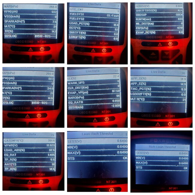

ANN SENN
  • 49 POSTS
It is definitely leaking or stuck open in under 1min gas went from 140 miles till empty to 127 plus strong shell of gas and thick smoke.
May 16, 2024 at 6:12 AM
ANN SENN
  • 49 POSTS

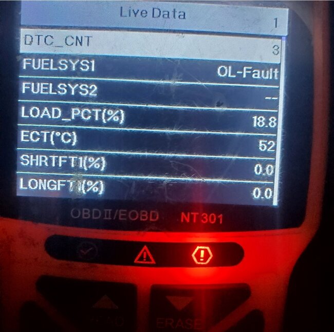

Ordered new injectors should be in today. The pics are with the car running. The spark adv. Jumped up to 25 could that be from injectors because those and coils were replaced.
May 16, 2024 at 6:15 AM
ANN SENN
  • 49 POSTS
I made a collage because it would only let me upload one picture at a time and then I'd have to send them one by one.
May 16, 2024 at 6:16 AM

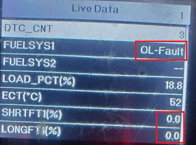

ANN SENN
  • 49 POSTS
Had no reading for short and long fuel trim?
May 16, 2024 at 6:17 AM
ANN SENN
  • 49 POSTS
Codes were 0302, 0300, 0108
Mf in 2, random mf, and map sensor one- which I'll address today while waiting for injectors.
May 16, 2024 at 6:27 AM
AL514
  • 5,502 POSTS
There's no fuel trim data because the vehicle has a fuel system fault, see where it says OL-Fault, that's the fuel system staying in Open Loop operations due to the faults. This is a very basic scan tool and is only giving you global OBD2 data, it's not going to be much help. Your front Air/Fuel ratio sensor reading is extremely rich at -2.938ma. that should be close to 0 and the EQ_RATII should be close to 1. Being in OL (open loop) operation the PCM is only taking input data from a couple sensors, you need to know what the Fuel Rail pressure is. And you need to check the MAP sensor to determine what that fault is.
May 16, 2024 at 9:32 AM
AL514
  • 5,502 POSTS
Watch the data PID FRP(kPa) when you turn the vehicle off. Turn the key right back to On, engine Off and watch that data PID, that's the Fuel Rail Pressure data, if it drops off quickly then an injector might be leaking, but the MAP sensor reading of 255kPa is too high, does that change if you push on the gas pedal when idling in Park? It should go much lower.
Can you change the scan tool setting also so the FRP is reading in psi and not kPa? But really you need to monitor that 4210kPa data PID, if it does drop off with the key On, engine Off, then it may not be an injector, check that first. And if you're changing GDI injectors make sure you pull the fuel pump relay for the pump in the gas tank and relieve the pressure first before cracking the high-pressure lines open. There's 1000s of pounds of pressure there, and you can get hurt very easily.
May 16, 2024 at 9:42 AM

ANN SENN
  • 49 POSTS
The fuel rail pressure dropped drastically as soon as I had the key on engine off. MAP sensor didn't change when i revved the gas though. I just replaced that maybe it's a bad sensor.
May 16, 2024 at 1:33 PM
ANN SENN
  • 49 POSTS
And I changed it so the MAP sensor now reads 37.
May 16, 2024 at 1:34 PM
