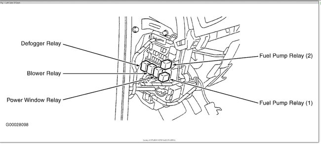

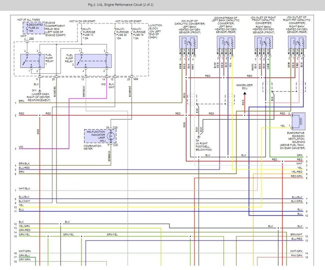

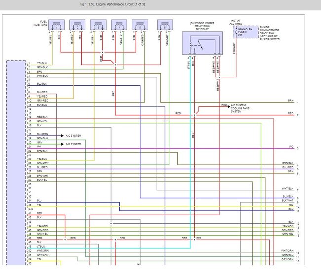

Son drove car from Phoenix Arizona. About eighty miles. Parked car at my house all day. Left the house and got about a block away in car and it shut off. I listened to hear fuel pump and heard nothing. I replaced fuel pump. But I still does not get the two second fuel pump start-up reaction. The fuel pump does pump when cranking engine but engine still does not start. Also, the gas does not come out the return line to the tank. What now?

Sounds like it may be the fuel pump relay not working correctly. Please follow the attached guide on how to test the relay and fuel pump relay wiring diagram to verify this is the issue.
Please run down these guides and diagrams and report back.

I followed the guides and diagrams and it was the relay not working right. $32.00 and it is back on the road.
