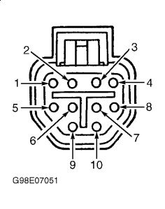

2. Check Electrical Signal Operation Disconnect transaxle harness connector. Inspect condition of connector and repair as needed. Using DVOM, connect positive lead to transaxle harness connector terminal No. 7 and negative lead to terminal No. 3. See Fig. 7 . While monitoring DVOM, press START and STOP to cycle solenoid output on and off. If voltage changes at least .5 volt, go to step 5 . If voltage does not change as specified, go to next step.
http://www.2carpros.com/forum/automotive_pictures/55316_99sablefig7_1.jpg

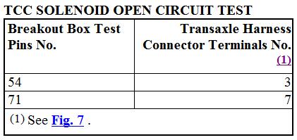

3. Check Continuity Of TCC Solenoid Signal & VPWR Harness Circuits Ensure ignition switch is turned to OFF position. Disconnect PCM 104-pin connector, and inspect it for damaged pins, corrosion and loose wires. Repair as necessary. Install breakout box, leaving PCM disconnected. Measure and record resistances between specified breakout box test pins and transaxle harness connector terminals. See TCC SOLENOID OPEN CIRCUIT TEST . If each resistance reading is less than 5 ohms, go to next step. If any resistance reading is 5 ohms or more, repair open circuit. Connect all components. Disconnect breakout box. Clear DTCs.
http://www.2carpros.com/forum/automotive_pictures/55316_99sabletcc_1.jpg

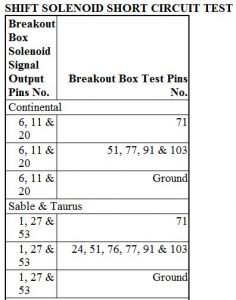

4. Check TCC Solenoid/Harness For Shorts To Power & Ground Measure and record resistance between specified breakout box test pins. See TCC SOLENOID SHORT CIRCUIT TEST table. If each resistance reading is 10 k/ohms or more, go to next step. If any resistance measured is less than 10 k/ohms, repair short circuit. Connect all components. Disconnect breakout box. Clear DTCs
http://www.2carpros.com/forum/automotive_pictures/55316_99sabletcc2_1.jpg
