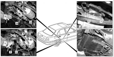

The fuel filter is located underneath the vehicle, near the passenger side rear axle, and covered by and underbody protection cover.
http://www.2carpros.com/forum/automotive_pictures/248015_1_34.jpg

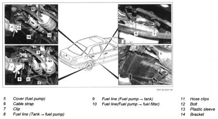

This is for the fuel pump and there is a TSB on the pumps - I have put that first.
TSB - Fuel System - Replacement Fuel Pump Adapter Harness
Date: November 6, 2001
Order No.: P-B-47.20/20
Supersedes:
Group: 47
SUBJECT:
C-Class
Fuel Filter Assembly
For C-Class models, the fuel pump assembly, part number 203 470 13 94, has been substituted in production by a new part, 203 470 28 94.
In vehicles where an old fuel pump assembly (203 470 13 94) is replaced with the new fuel pump assembly (203 470 28 94), plate with attached harness, part number 203 470 27 41 (replacement for 203 470 02 41) needs to be installed together with the new pump assembly. Failure to install the two parts together will not allow the vehicle side of the harness to be plugged into the new fuel pump
Removing, Installing Fuel Pump
http://www.2carpros.com/forum/automotive_pictures/248015_2_24.jpg
http://www.2carpros.com/forum/automotive_pictures/248015_3_21.jpg

1 Disconnect and connect the ground cable at the battery
NOTE: Installation:
After connecting the ground cable, read out error memory, encode radio and calibrate power window
Vehicles with stationary heater: set stationary heater clock.
2 Remove trunk cover (1)
3 Remove cover (2)
4 Ascertain as-build condition
Fuel line with banjo bolt at fuel pump.
5 Unplug connector (5)
6 Press rubber grommet (4) out of floor panel
NOTE: Installation: Check rubber grommet for damage and correct installation.
CAUTION: If damaged: replace rubber grommet.
7 Remove cover (5) of fuel pump
NOTE: Unscrew the three nuts of cover through holes (arrows).
8 Remove cable strap (6) and clip (7)
9 Unclip fuel lines (8, 9, 10)
See Special Tools below.
10 Pull fuel lines (8,9,10) off fuel pump (M3)
NOTE: Installation: Replace hose clips (11).
11 Loosen bolt(12)
12 Remove fuel pump (M3) in direction of arrow
NOTE:
Removal:
Do not damage the insulation of the cable and plug of connector (3) when pulling through floor panel. Installation:
Check plastic sleeve (13) for damage.
If damaged: replace plastic sleeve (56a).
The plastic sleeve (13) must overlap on both sides of the bracket (14) since corrosion may occur if the fuel pump touches the bracket directly.
13 Install in reverse sequence
