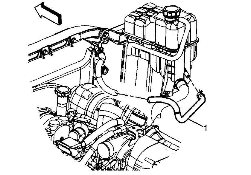

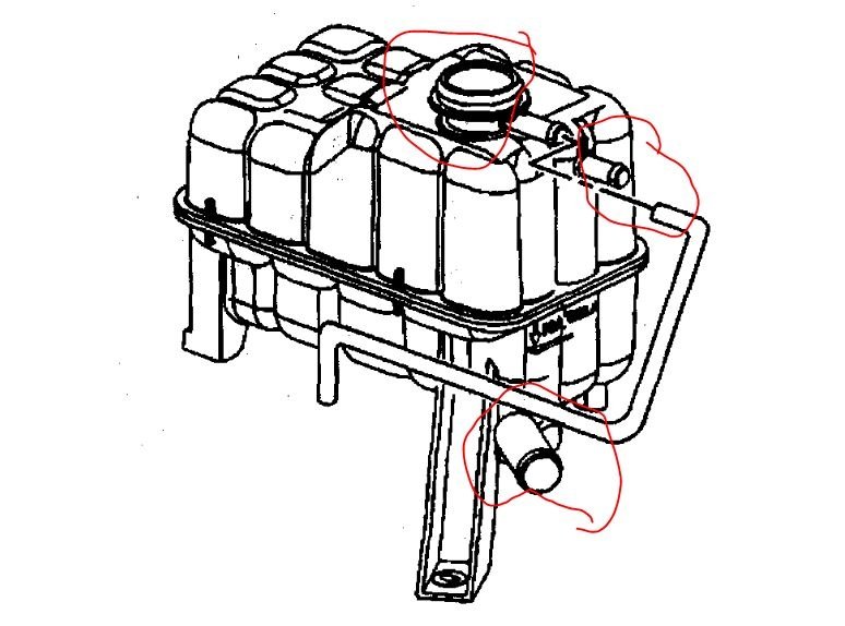

The low coolant light came on, when added I can see it dripping out, however I could see from where. It was near the tire. It's an old truck so worried that it's not an easy fix.
Jan 18, 2020 at 6:27 AM
  • CAR REPAIR CONTRIBUTOR
Good afternoon,
Can you post some pictures of the location of the leak?
https://www.2carpros.com/articles/car-is-leaking-coolant
You can rent a pressure tester to determine the exact location of the leak.
https://www.2carpros.com/articles/radiator-pressure-test
Right above the tire is the surge tank. I circled the most common areas for leaks.
