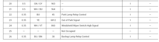

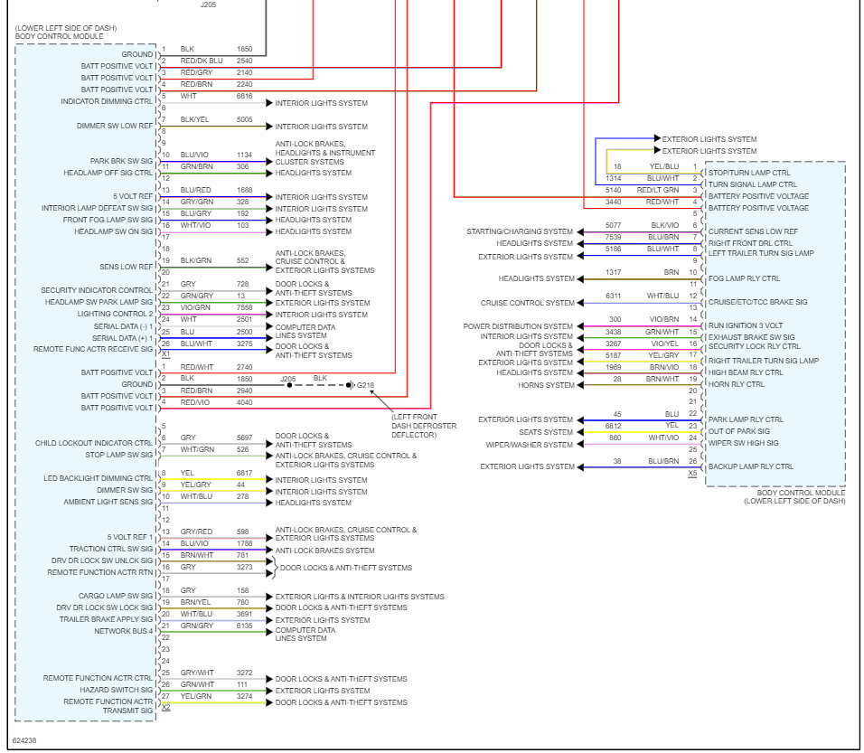

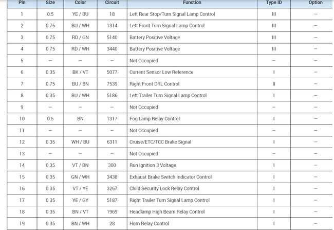

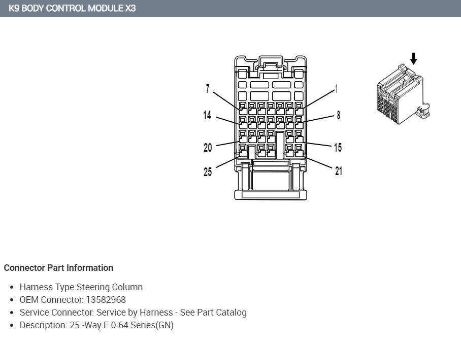

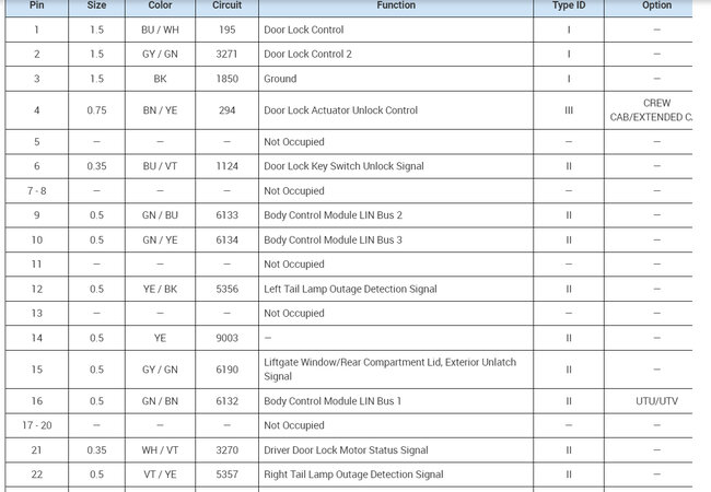

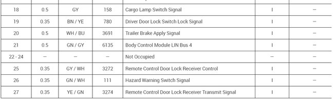

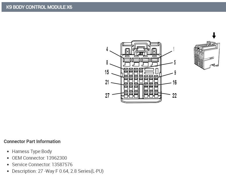

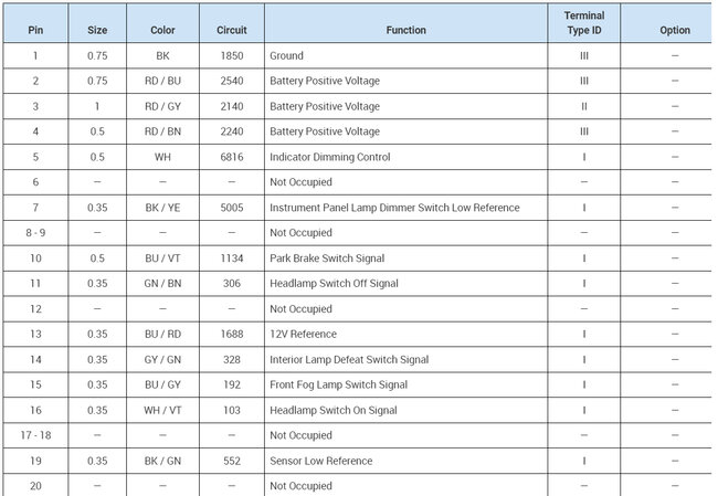

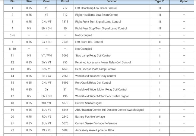

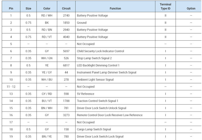

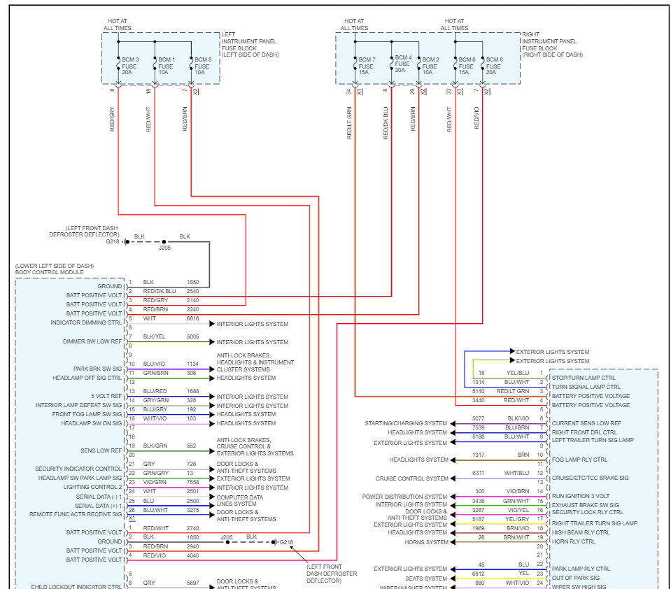

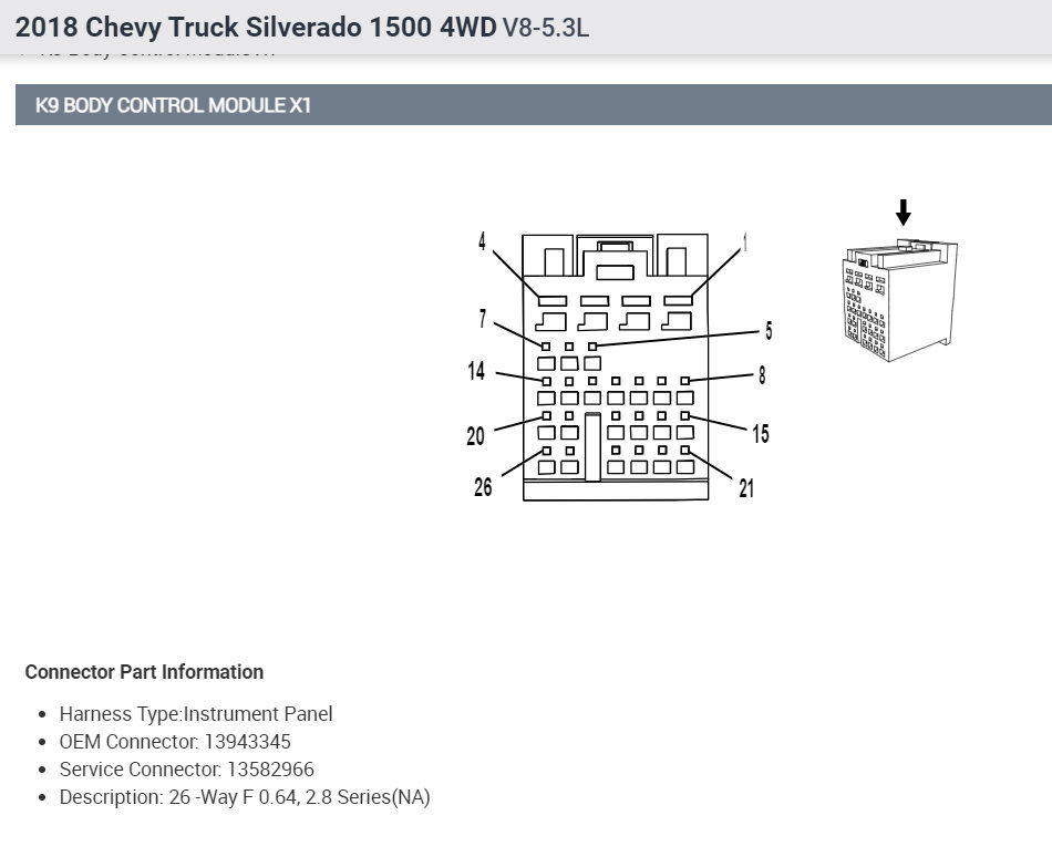

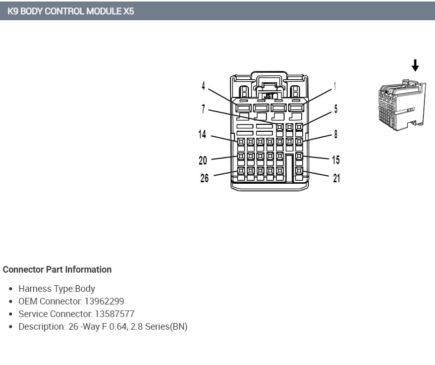

Looking for BCM diagram, pin out diagrams and terminal identification?
2018 CHEVROLET SILVERADO
40,000 MILES • 5.0L • V8 • 4WD • AUTOMATIC
JOHN SONNY

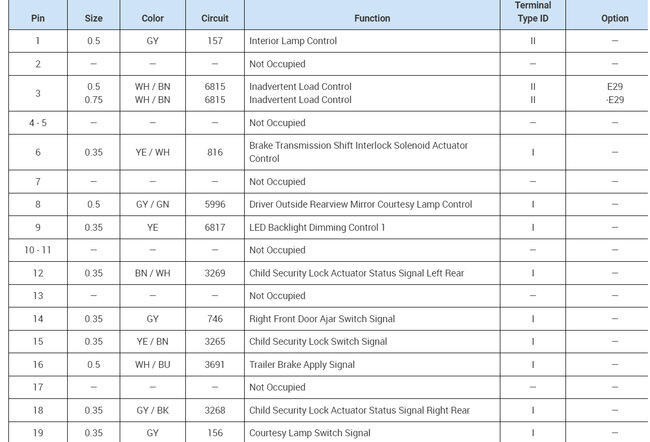

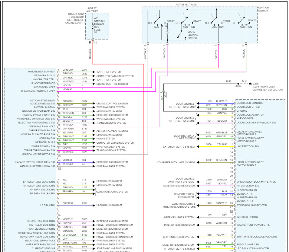

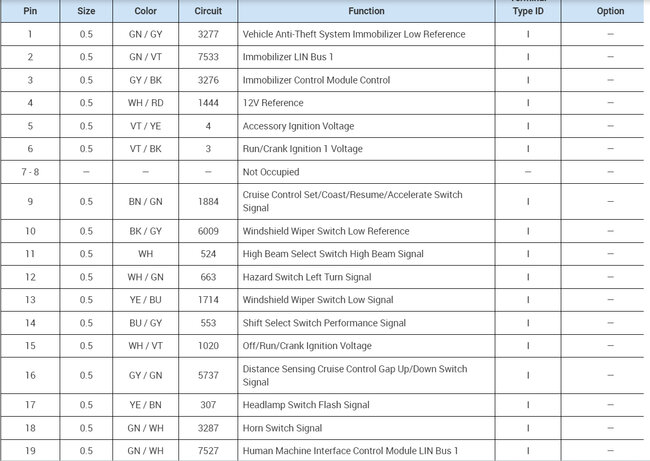

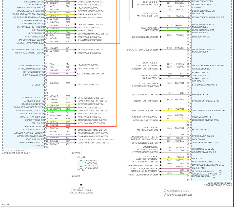

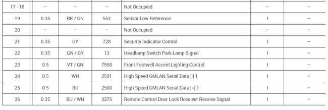

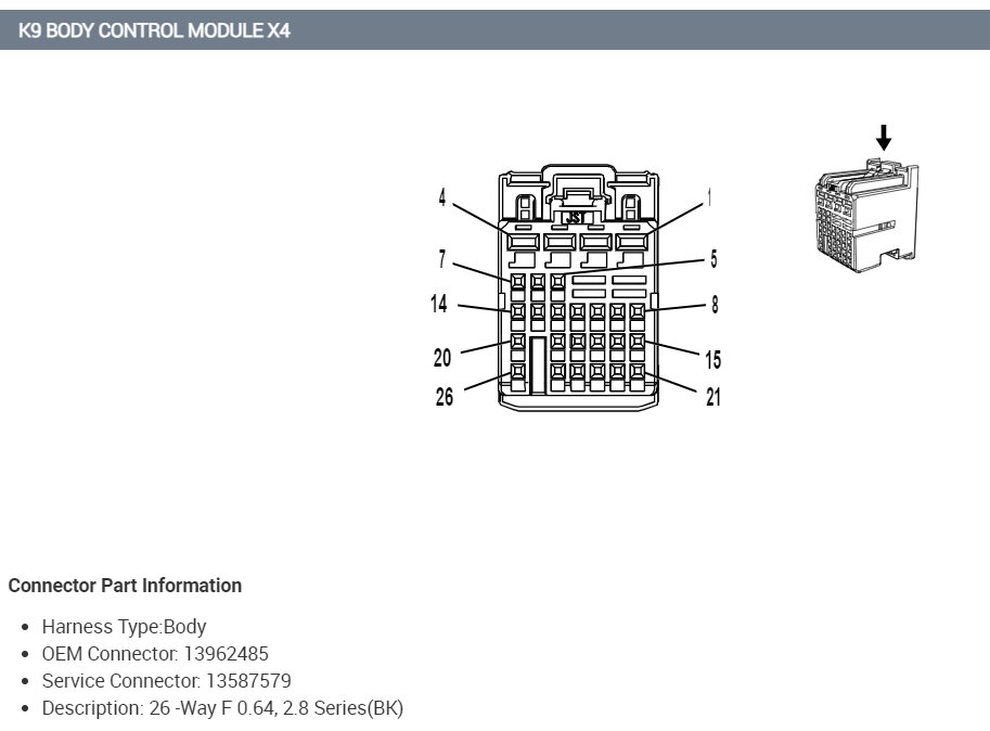

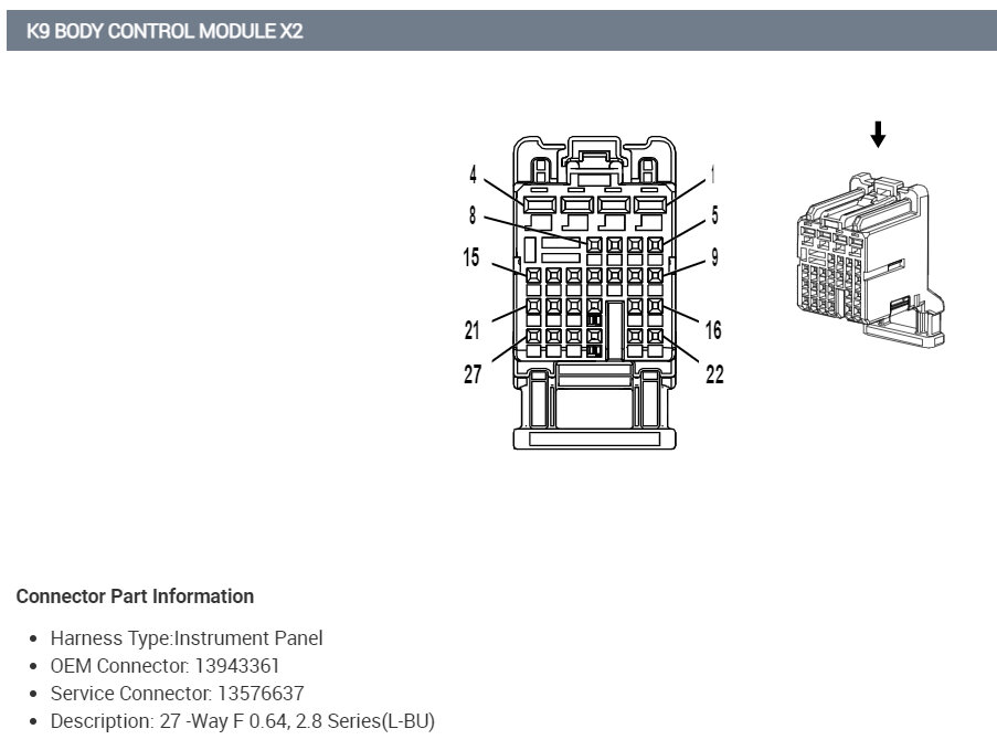

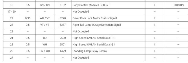

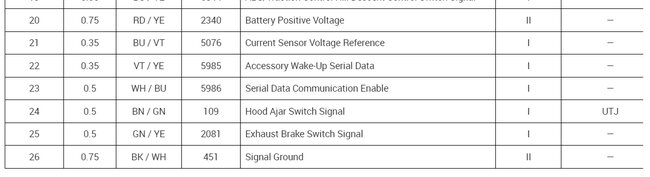

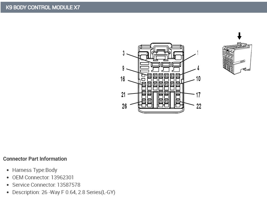

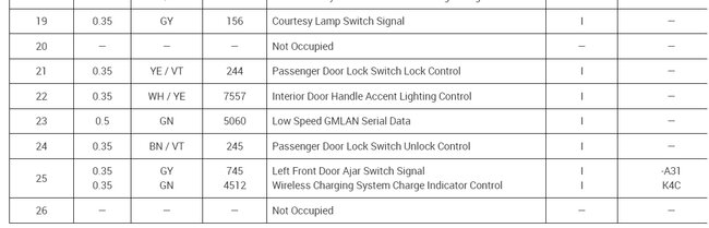

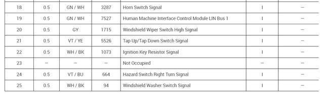

The truck functioning normally was going to add LED lights to running boards and want them to run off the interior LED lights. Therefore, when the truck is unlocked or if the door is opened the lights will turn on.
Sep 12, 2023 at 9:42 AM
  • CAR REPAIR CONTRIBUTOR
  • 54,334 POSTS
Yep, here you go. These are the BCM wiring diagrams and connector pinouts. This guide can help you test the connections if needed.
Check out the images (below). Please let us know how it goes.
