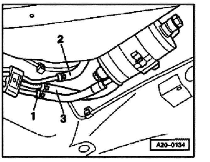

I am having a problem locating my fuel filter. I located the fuel regulator underneath on passenger side and I am wondering if they are both combined into one. please help.
Nov 28, 2017 at 12:36 AM
PATENTED_REPAIR_PRO
  • CAR REPAIR CONTRIBUTOR
  • 1,853 POSTS

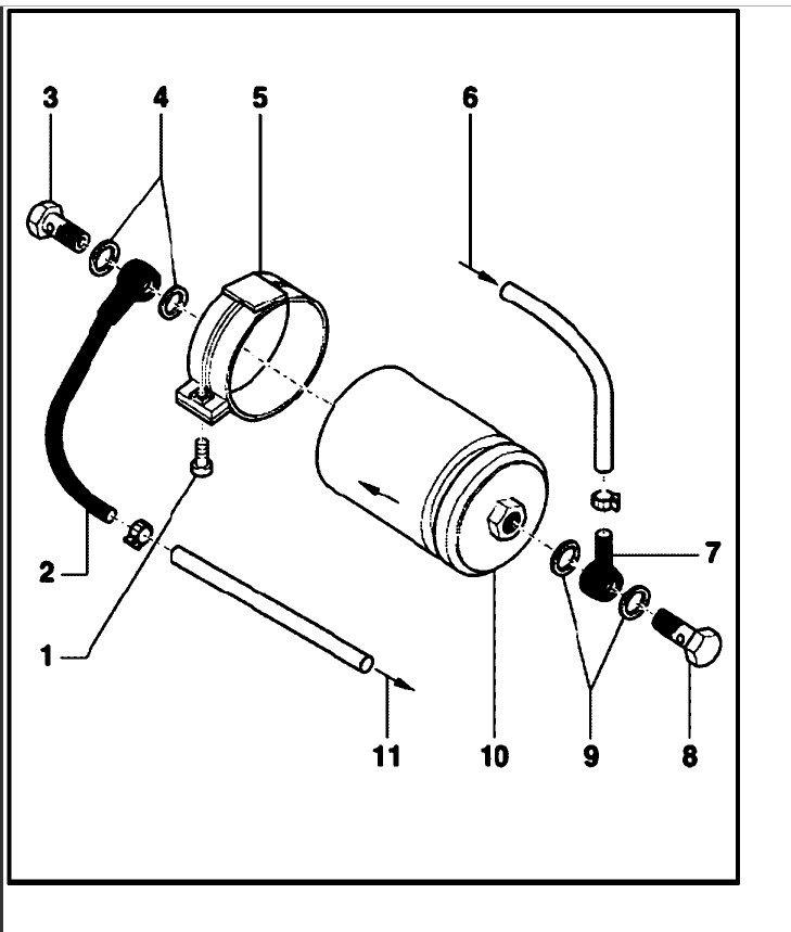

Yes, you are correct. Fuel filter with pressure regulator. It is number three in this diagram. Check out the diagrams (Below). Please let us know if you need anything else to get the problem fixed.

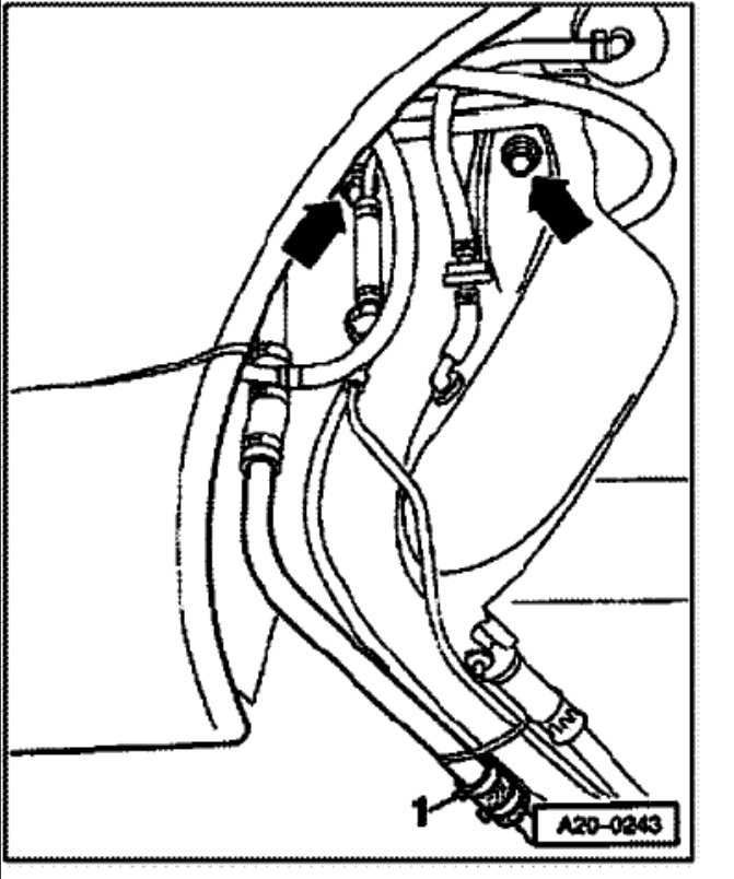

Servicing fuel filter Fuel Filter Located Behind Cover
https://images.2carpros.com/forum/automotive_pictures/12900_f1_16.jpg
Remove 2 bolts (arrows) for fuel filler neck underneath rehousingg liner. WARNING: Fire Hazard. Do not smoke, work near heaters or have anything in the area that could ignite the fuel or fumes. Fuel supply lines are under pressure! Before loosening any lines, cover the connection with a rag. Release the pressure by slowly separating the connection.
https://images.2carpros.com/forum/automotive_pictures/12900_f2_16.jpg
Fuel Filter With Cover Removed Mark supply line -3-, return line -2- and vent line -1- and disconnect https://www.2carpros.com/kpages/auto_repair_manuals_alldata.htm

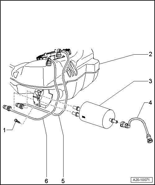

It is under the car near the tank. You will need a jack to get to it.
Here is a guide so you can do the job safely:
This guide will give you an idea of what you are in for.
https://www.2carpros.com/articles/how-to-change-a-fuel-filter
Below are some diagrams of the job being done on your car.
