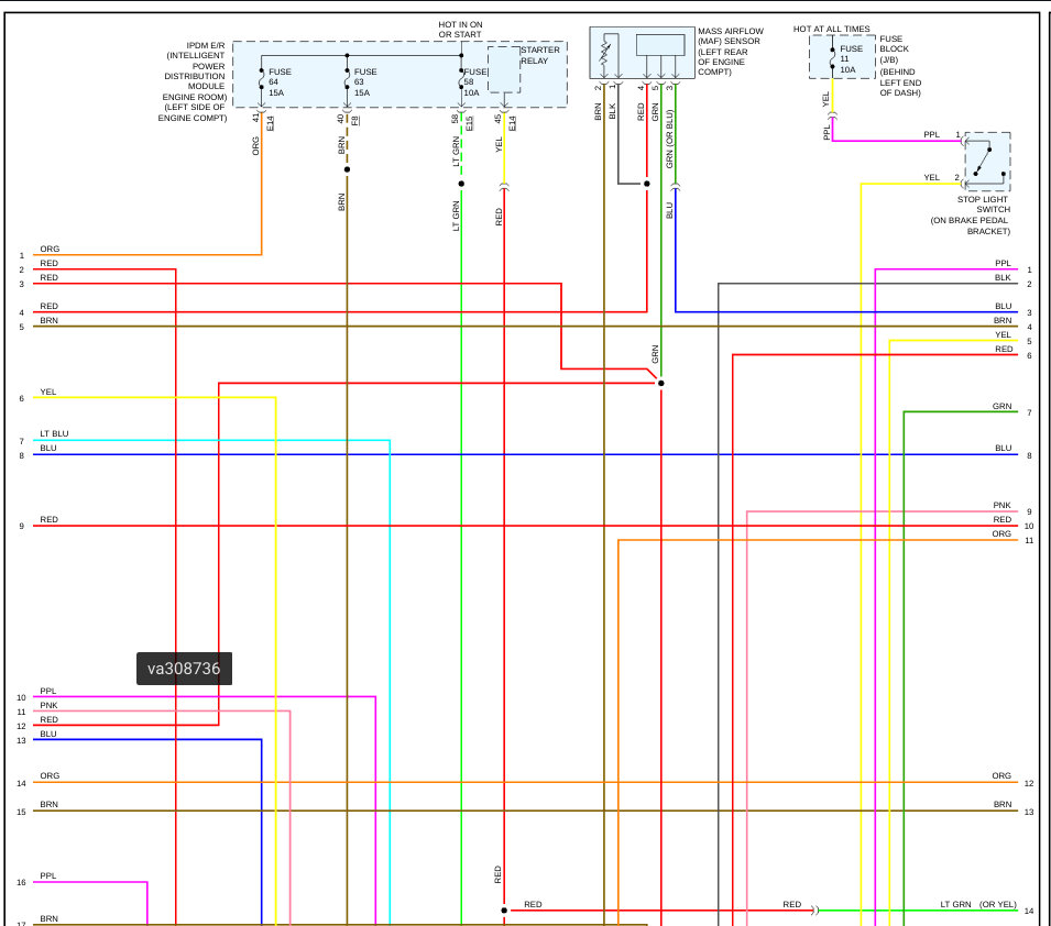

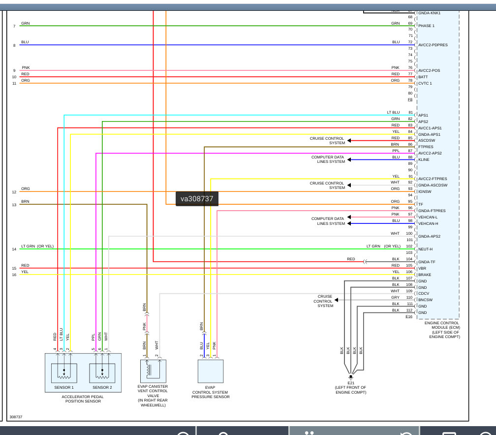

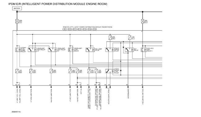

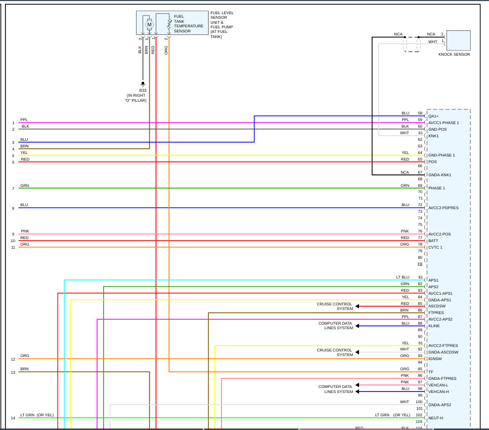

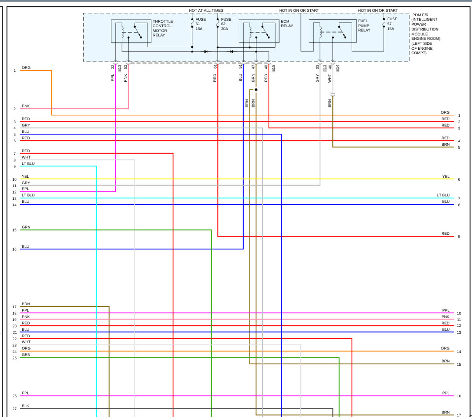

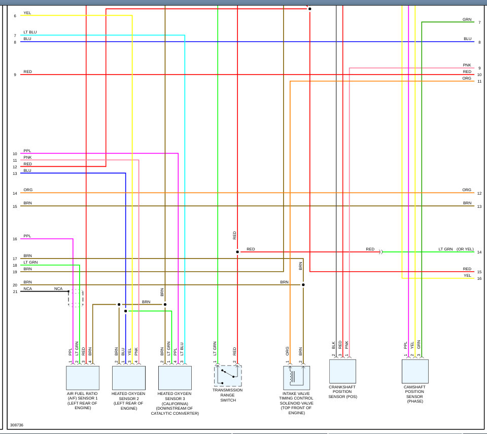

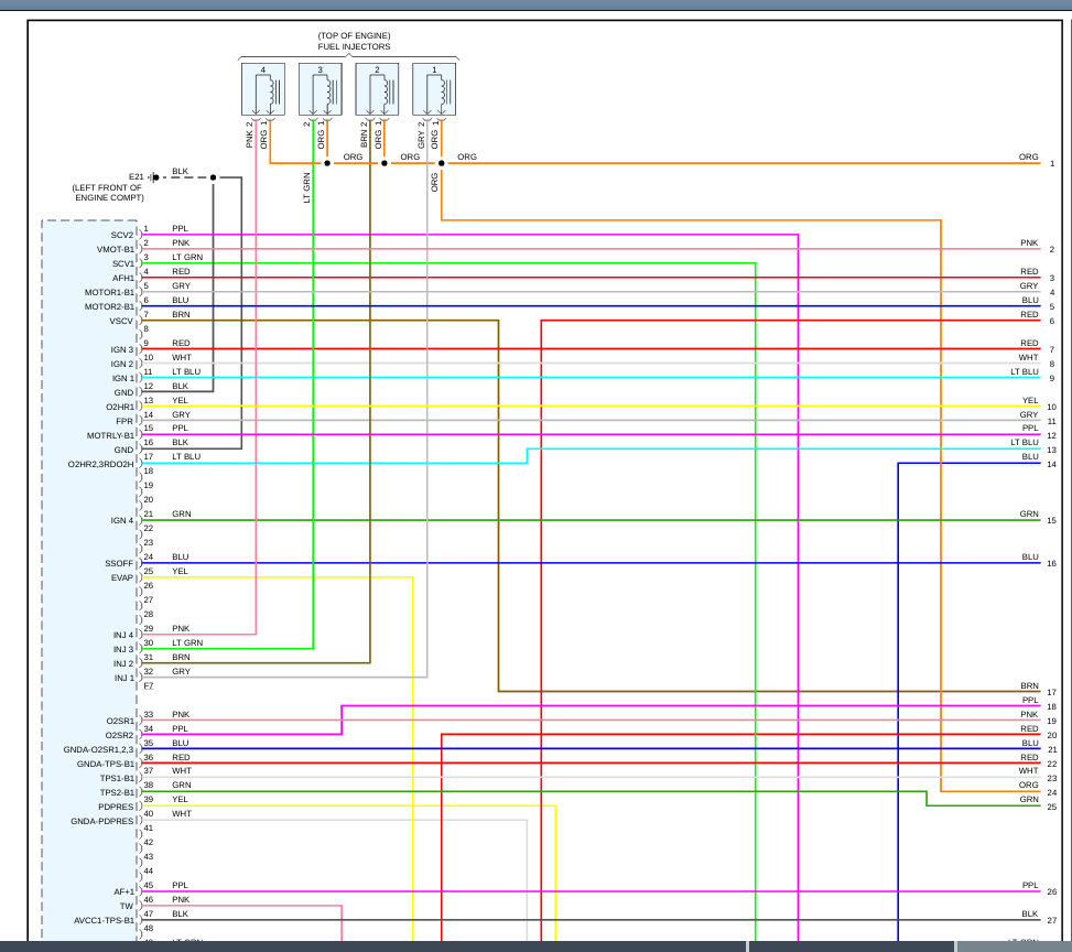

After sitting for two weeks, my vehicle will not start. I have changed the plugs and tested the battery. Air filter is new and in good shape. I think the fuel pump may be bad but want to test the relay switch first; however, I cannot find the relay. i did find a fuse and it is in good condition. Does this vehicle not have a fuel pump relay?
Feb 1, 2020 at 1:31 PM
SCGRANTURISMO
  • CAR REPAIR CONTRIBUTOR
  • 4,897 POSTS

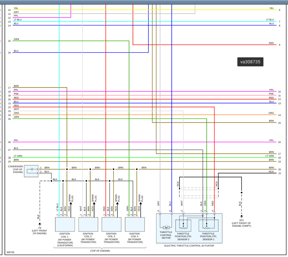

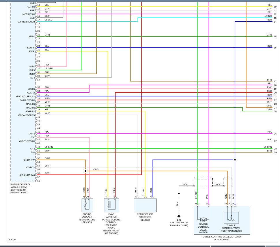

The fuel pump relay is located in the intelligent Power Distribution Module[Engine Room][IPDM]. In the diagrams down below I have included the power-train management wiring diagram for your vehicle as well as the wiring diagram for the IPDM. Please go through these guides and get back to us with how everything turns out.
