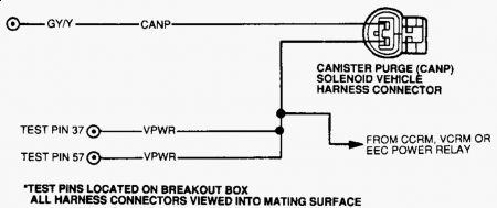

STILL LOOKING FOR SUGGESTIONS OF THINGS TO CHECK THAT MIGHT CAUSE THIS ROUGH RUNNING PROBLEM as none were given in the response
Fixed egr tube problem, new sensor/solenoid thing, replaced both coils, wires, and plugs. Got some improvement--no longer stalls at idle. However, engine VERY rough from 0-30mph approximately, and up to 1000 or 1500rpm--at higher speeds, smoothe as can be, runs great then. But not driveable around town at this point. Main code we get now is 565 cannister purge solenoid-circuit failure, which we replaced but code still comes up. What does circuit failure mean, and how do we find the actual problem? (Check engine light still comes on immediately after all repairs so far) continuous memory code 238 still comes up but we replaced both coils. And what might cause that rough rough running at low speeds that might not show up as a code? How to check those things? I donated once, and was told I could get more help, but haven't figured out how. So donating smaller amount this time. How do I make follow up questions--never able to find anything except to send to general free answer area. Thank you!

For code 565 pay particular attention to #6 in these instructions.
CIRCUIT TEST KD - CANISTER PURGE (CANP) Diagnostic Aids Perform this test when instructed by QUICK TEST or if directed by other test procedures. This test is only intended to diagnose: CANP solenoid. " Harness circuits (CANP and VPWR). " Powertrain Control Module (PCM). "
http://www.2carpros.com/forum/automotive_pictures/62217_1_7.jpg
http://www.2carpros.com/forum/automotive_pictures/62217_2_7.jpg
1) Check System Function Use only VOM or DVOM for this step. DO NOT use scan tester. Turn ignition off. Disconnect cruise control servo wiring harness connector. Connect DVOM negative lead to STO terminal at Data Link Connector (DLC). Connect positive lead to positive battery terminal. Install a jumper wire between STI terminal and SIG RTN terminal at DLC. See Fig. 26 -22. Perform KOEO SELF-TEST until continuous memory test is complete. DVOM will read less than 1.0 volt when test is complete to indicate PCM has entered OUTPUT STATE CHECK. Depress and release throttle. If voltage increases, remain in OUTPUT STATE CHECK and go to step 2). If voltage does not increase, depress throttle to WOT and release. If STO voltage does not increase, leave test equipment hooked up and go to CIRCUIT TEST QC. 2) Check CANP Solenoid Electrical Function Turn ignition on. Disconnect CANP solenoid. Connect DVOM positive test lead to VPWR terminal and negative test lead to CANP terminal at solenoid wiring harness connector. While observing DVOM, depress and release throttle several times to cycle output on and off. If CANP circuit voltage does not cycle 0.5 volt or more, remove jumper wire and go to step 7). If CANP circuit voltage cycles, remain in OUTPUT STATE CHECK and go to step 3). 3) Check Solenoid For Vacuum Leaks Turn ignition on. Leave CANP solenoid disconnected. Disconnect vacuum hose at CANP solenoid from manifold vacuum side of solenoid. Apply 16 in. Hg vacuum to manifold vacuum side of CANP solenoid. If CANP solenoid does not hold vacuum for 20 seconds, replace solenoid and repeat QUICK TEST. If fault is still present, service fuel evaporation canister or hoses. If CANP holds vacuum for 20 seconds, remain in OUTPUT STATE CHECK, leave vacuum pump attached and go to step 4). 4) Check Solenoid Mechanical Operation Connect CANP solenoid connector. Apply 16 in. Hg vacuum to manifold vacuum side of CANP solenoid. Depress and release throttle. If vacuum is released, check hose from CANP solenoid to canister for leaks and cracks. If hose is okay, remove jumper wire from STI to SIG RTN and go to step 5). If vacuum is not released, check hose from CANP solenoid to canister for blockage or kinks. If hose is okay, replace CANP solenoid and repeat QUICK TEST. 5) Check Vacuum Supply To CANP Solenoid Disconnect vacuum hose from CANP solenoid on manifold vacuum side. Start engine. If vacuum is present at vacuum hose, engine control system is okay. Check evaporative canister. If vacuum is not present at hose, check vacuum hose for improper routing, kinks and blockage. If hose is okay, check engine for mechanical cause of low vacuum. 6) Code 85/565 Or 569: Check CANP Solenoid Resistance Code 85/565 or 569 indicates fault in CANP solenoid circuit. Possible causes for this fault are: Faulty CANP solenoid. " Open or short circuit in wiring harness circuit. " Faulty PCM. " Turn ignition off. Disconnect CANP solenoid connector. Measure CANP solenoid resistance. If resistance is 40-90 ohms, go to step 7). If resistance is not 40-90 ohms, replace CANP solenoid and repeat QUICK TEST. 7) Check Voltage Of VPWR Circuit With CANP solenoid disconnected, turn ignition on. Measure voltage between VPWR terminal at CANP solenoid harness connector and negative battery terminal. If reading is 10.5 volts or more, go to step 8). If reading is less than 10.5 volts, repair open circuit and repeat QUICK TEST. 8) Check Continuity Of CANP Circuit Turn ignition off. Disconnect CANP solenoid. Disconnect 60-pin PCM connector. Inspect terminals, and repair if damaged. Install Breakout Box (T83L-50-EEC -IV), leaving PCM disconnected. Measure resistance between CANP circuit breakout box test pin (No. 11, 15 or 31) and CANP harness connector. If reading is less than 5 ohms, go to step 9). If reading is 5 ohms or more, repair open circuit and repeat QUICK TEST. 9) Check CANP Circuit For Short To Ground Turn ignition off. With CANP solenoid disconnected, measure resistance between CANP circuit breakout box test pin (No. 11, 15 or 31) and pins No. 40, 46 and 60. If all readings are 10,000 ohms or more, go to step 10). If any reading is less than 10,000 ohms, repair short to ground and repeat QUICK TEST. 10) Check CANP Circuit For Short To Power Turn ignition off. With CANP solenoid and PCM disconnected, measure resistance between CANP circuit breakout box test pin and test pins No. 37 and 57. If all readings are 10,000 ohms or more, replace PCM and repeat QUICK TEST. If any reading is less than 10,000 ohms, repair short to power and repeat QUICK TEST.
