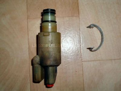

hello, on my air suspension, the air bags wouldnt air up. I noticed that my pump wasnt running, so I checked fuses relays. Everything was good. I ran a jumper to the pump and it turned on. Then I seen no air coming out of dryer. Took the pump a part and it was all chewed up. So I got a new one and hook it up and still no power. So I ran a jumper to the pump again and it worked. Found two leak on drivers side the line was cut on both and the sillenoid wire where cut to and hook them back up. No leaks now but wont inflate. There is only one air bag that will inflate but no other. And switch is on. Thanks

Test the solenoids and check for leaks in airbags

Spring solenoid testing '90 - '94 Town Cars
Switch the air suspension off and disconnect the control module connector. Next, gain access to the spring solenoids and disconnect the solenoid connectors. Now ground the Purple/Light Green and Light Blue/Black wires on the module connector. Next, using a voltmeter or test light bridge the two terminals of each spring solenoid connector and you should have battery voltage (test light lit). If not then connect your voltmeter to the Orange/Red wire of the solenoid connector and to a good chassis ground and you should have battery voltage. If not, check fuse U. If fuse U is okay then you have a wiring fault between the power distribution box and the spring solenoid. If you have battery voltage on the Orange/Red wire and when the two-solenoid connectors were previously bridged you did not get battery voltage then you have a wiring fault on the wire (Purple/Light Green or Light Blue/Black) between the control module and spring solenoid. Finally, remove the jumper wires from the control module connector and with your voltmeter or test light bridge the spring solenoid connectors - if you get battery voltage then the wire (Purple/Light Green or Light Blue/Black) between the control module and spring solenoid is shorted to ground.
From these tests you will know if the wiring is okay. If during the previous venting test one or both air springs didn't vent and the wiring is okay, then it would be safe to assume that you have a bad spring solenoid(s).
http://www.2carpros.com/forum/automotive_pictures/52960_00061_3_3.jpg
The picture above shows a spring solenoid and retaining clip.
