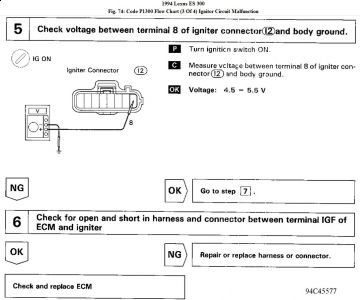

1994 lexus es300 cranks fine runs 5 mins then shuts off. Will not fire back up for 10 to 15 mis. Not over heating, replace cam and crankshaft sensor and Ignition igniter my tech has lost his mind with this car. Just checked with the tech and he said the Ignition Igniter is getting really hot. The old one and a used one we got from salvage yard. Gets hot when the key is turned on and the car is not running. When something cools down say 20 to 30 mins of sitting car cranks up and idles with no problem or will drive with no problem for 2 to 5 mins. The computer tester only gives the code for ignition igniter. No other codes or problems are returned.

CODE P1300
We've replaced the igniter. The igniter gets really hot idling 5 mins or drive for five mins.

diagnostic code after ecm cleared and the car runs for 5 mins then shuts off is P1300 The ignition ignitor is getting rather HOT to the touch after it runs for 2 to 5 mins then the car simply shuts off and will turn over but will not attempt to fire for the next 20 or 30 mins. I sprayed duster upside down on the ignitor last night to see if that would cool it and make it run but it did not help
code is for a shorted out coil which if it's shorted out will cause the ignitor to overheat have you changed any coil packs

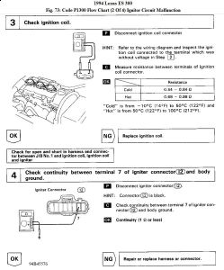

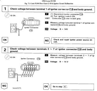

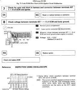

Here are the diagnostic work flow. Go through them and see if you can come up with anything.
https://images.2carpros.com/forum/automotive_pictures/192750_P1300Flow94ES300Fig72_1.jpg
https://images.2carpros.com/forum/automotive_pictures/192750_P1300Flow94ES300Fig73_1.jpg
https://images.2carpros.com/forum/automotive_pictures/192750_P1300Flow94ES300Fig74_1.jpg
https://images.2carpros.com/forum/automotive_pictures/192750_P1300Flow94ES300Fig75_1.jpg
Btw if you think that all mechanics makes lot of money, you are wrong. If there is a question that we have answered, we would try our best to get it solved. Our site here is to help as many people as possible and it gives us satisfaction to be able to contribute to society. If you require further assistance, just reply to post and I will get back to you once I receive notification.

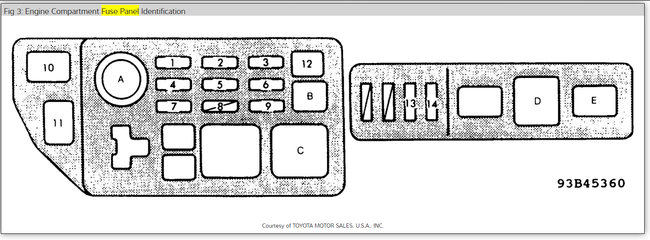

I am having the same problem with my 94 lexus es300. You said you changed the relay and it stopped. What relay are you referring too?
Oct 9, 2009 at 3:01 PM
GRASH00
  • 13 POSTS
The Relay I'm talking about is on the passenger side on the right. There is one screw you have to remove you can turn that screw by hand. Once that cover is off you'll see a black relay and a fuse in there.

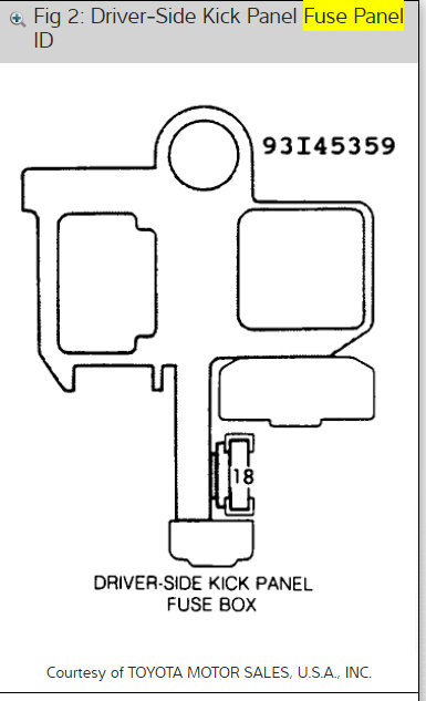

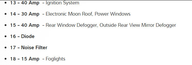

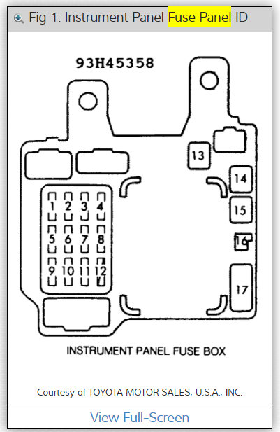

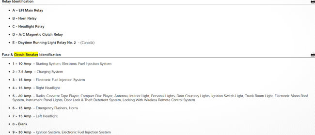

It sounds like a relay or the ignition igniter this is an old post so they may not respond we may need to start from the beginning and site their information to help guide us along. Can you please run the codes to see what comes up?
Mar 22, 2018 at 11:42 AM
SETEFANOD
  • 25 POSTS
It has igniter code but i have replaced with new already. Code still repeats to come back. I will take off battery and let code clear and will run for anywhere from 30 min to 1 hour then stall again and not start.
Mar 23, 2018 at 11:54 AM
  • CAR REPAIR CONTRIBUTOR
  • 54,350 POSTS

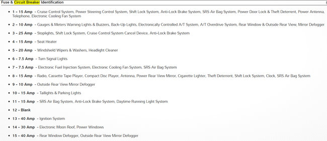

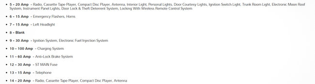

I think the relay he was talking about was the EFI relay which I have seen problems with. Here is a guide to test and the location of the relay.
