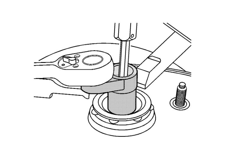

Good morning,
Were the strut mounts replaced when the struts were installed? That is common.

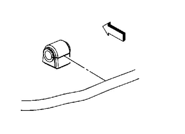

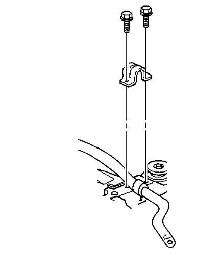

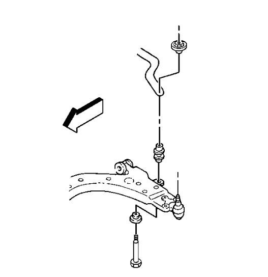

Yes, the sway bar can be the noise. Replace that.
