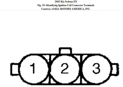

hello, I am having a lack of power at part throttle. Seems to idle fine and responds ok at light throttle positions but losses power as the throttle is opened more. When I back out of the throttle it feels like it kicks back in and runs better. Pulled codes and had maf code, checked pid with scan tool and it was 0, replaced maf and rechecked pid- was working normal but still had this performance problem. On test drive the check engine light was coming on under full throttle but going off at light throttle, rechecked codes and had p301. Pulled intake and replaced all plugs, swapped injectors around as well as plug wires, retest drove, same problem but now has codes p300, p301, p305.
any ideas what is wrong? Thank you

3. Disconnect suspected ignition coil 3-pin harness connector.
http://www.2carpros.com/forum/automotive_pictures/192750_IgnitionCoil02SedonaFig19_1.jpg
Turn ignition on. Measure voltage between ground and suspected ignition coil connector terminal No. 3 (Red wire). Voltage should be battery voltage. If voltage is as specified, go to next step. If voltage
is not as specified, repair open circuit between ignition switch and suspected ignition coil connector terminal No. 3 (Red wire). After repair, go to step 10 .
