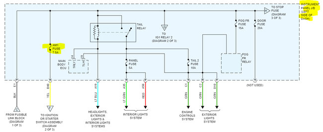

My car had a flat tire, and instead of replacing it with a spare tire, the driver decided to drive on it for a long distance. The tire was worn down to the rim and I believed it was driven on the rim for a long time. When it got home, the driver could shut it off and removed the car key. I then use another car key too while hooking up the code reader to read the error code that caused the ABS light to turn on, and I can't turn it into lock position to remove it out. The steering wheel can be turned all the way to stop. Car recognizes the Park position, because I can see P was on the dashboard and also in my code reader.
What could be the causes of this problem so I can go in the right direction? I'm afraid the vibration from the rim could cause something to turn loose also. Wheel well fender was ripped off and ABS sensor was yank off. Thank you!

Are you sure the shift lever is making it fully into park? With the engine off and the shifter in park, are you able to shift it without pressing the brake? Also, and don't laugh, do the brake lights work?

Yes, it's in a P. I can see it in dashboard and my scanner. With the engine off and key on, I can't shift without pressing brake like normal. The brake light is working. Car shifts and runs fine.

Also, when I move it in park after moving key from ON to AC, I can hear a click around ignition switch area. I think lock or unlock mechanism around the ignition switch gets the signal when car is in park. When I removed the transmission interlock solenoid, I see an built in switch that turns on when shift level moves to P, and it makes a click sound in the ignition switch area whenever I press it after turn key from ON to AC.

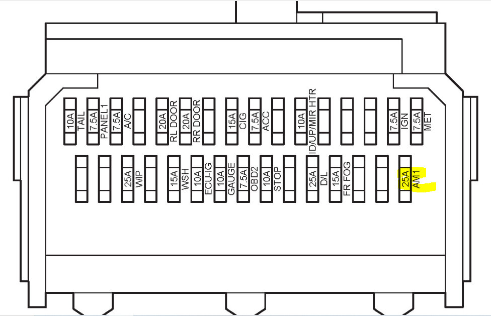

Check the AM1 fuse in the interior fuse box. I attached a pic below showing the location and the schematic. If the fuse is good, confirm there is power to and from it.
Let me know what you find.

I'm sorry, but I found out what's wrong with my car. The spare key has a silicone cover and it prevents the key to go in before turning to lock.
