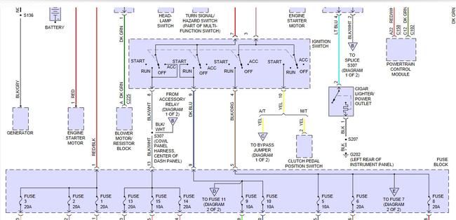

1999 Jeep Wrangler 4cyl 4wd. 106000 miles. Drove to the local gas station for a 6'er shut off my Jeep bought my goods got back in and it was dead just like that. Ran just fine before with the exception of it acting similar to starving for fuel at random times, speeds, & gears. The hole jeep would shake, extrem lose of power unless I left off the gas and only applied very little throttle.
So far I have confirmed that all the fuses, relays, & battery are fine through testing them and replacing battery. Still all I have is power to gauges, radio, lights etc. Just nothing when I turn the key over. No starter turning over just nothing. DEAD!
Sunday, June 22nd, 2008 AT 3:57 PM
41 Replies
  • 75,992 POSTS
Check fuse no.2 40amp if okay disconnect clutch switch -jumper the clutch switch on top of the brake pedal and see what happens. See circuitry below

JEEPMAN77
I tried a few things also minor things in my skills level. Checked fuses, relay's and bought a new battery since mine was to weak to pass a battery test. None of this helped so I got under it and played with the starter cleaning connections etc. Nothing. I brought it to a shop and they had it fixed in 4 hours. They found a few bad wires some of which are in the diagram I do believe.
Bottom line it was bad wiring from the starter and the clutch safety switch both. This was a bit much for me to deal with so I paid the $180.00 and had it fixed by a pro.

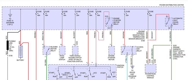

All the gauges and lights come on, but when I turn the key to "start", nothing happens other than the clock display going dark. I can hear the relays clicking a few times, but then nothing.
Saturday, September 26th, 2020 AT 12:28 PM (Merged)
INTERNETMECHANIC
  • 700 POSTS
I'd have to make sure the battery has a full charge and the connections are good. Did you try cranking in neutral? If it won't even crank, check the circuits at the starter relay. Terminal D10 is hot all the time. Terminal D11 goes hot with key in the crank position. Terminal D13 is ground for the coil side of relay and is wired through the neutral switch. When the relay is energized, that arm with the arrow-head switches to terminal D14, that circuit carries voltage to starter. Use a voltage tester on those circuits. I can't rule out the starter itself, right now. Some of the national brand autostores will test the starter for you, if you want to take it off and take it to them.

Brought new starter still won't start. Bypassed the starter relay and it started right up. Do I need to replace the relay?
Saturday, September 26th, 2020 AT 12:29 PM (Merged)
CARADIODOC
  • 33,738 POSTS
First feel if the relay is clicking when a helper turns the ignition switch to "crank". If it's not, it isn't the fault of the relay. It's the fault of the circuit that runs the relay, and the most common cause is the neutral safety switch. Try shifting between the gears a few times, then see if the system works.
