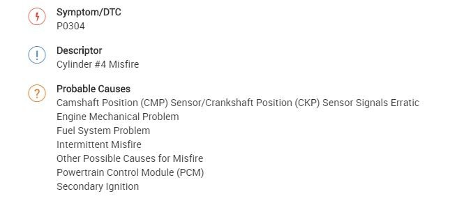

PO3O6, PO3O5, PO3O4
I believe were the codes.
Jan 8, 2020 at 11:28 AM
  • CAR REPAIR CONTRIBUTOR
Okay, thanks.

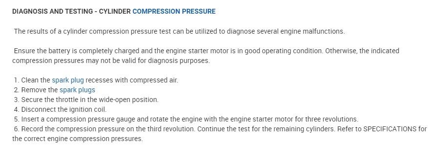

They are misfire codes for the engine cylinders 4,5 and 6.
You would need to do a compression test first to be sure there are no engine issues internally with the motor itself.
