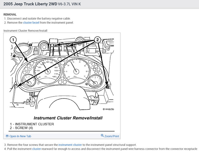

My speedometer and my odometer stopped working..I have replaced the 2 speedsensors on transmission and I also replaced the on the rear differential checked around the e brake cable in rear for wires worn and plus I checked on the drivers side of the Jeep inside under carpet all is good any suggestions

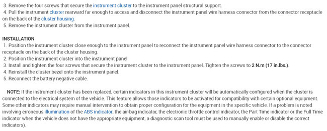

It sounds like the cluster must be replaced here is a video of the job being done on a similar car the process is the same.
https://youtu.be/_HEC44xENxw

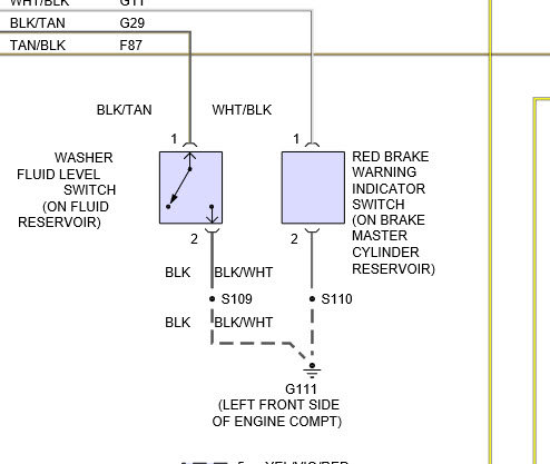

Okay, so I have changed the instrument panel twice and changed the sensors on the transmission as well as the rear speed/ABS sensor. Everything works fine in the cooler months but when it starts to get hot outside the speedometer stops working unless I am pressing the break pedal. Sometimes that fixes it and sometimes it just comes in and out while I am driving. Occasionally If I hit a bump It will work as well. I have even changed the connector on the rear sensor.I have run out of ideals on how to fix this. Anyone know what this could be?

Sounds like a ground problem if you hit a bump and it works check ground battery to body and engine to battery and ground on engine left front. They may be loose or corroded. Make sure two switches in picture are connected as it grounds through them as well.

HEATH CONLEY
How hard is it to get to these wires? I always have my roommate fix my cars.
Monday, March 4th, 2019 AT 11:22 AM (Merged)
HEATH CONLEY
One of the wires is corroded badly thinking it is for the brake thing. So that is probably it. I will have to get it fixed and will update after if it works or not.
