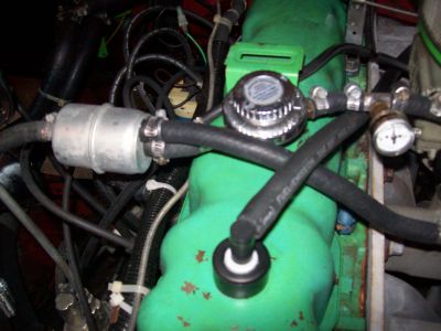

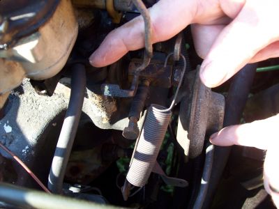

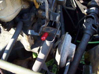

My jeep will not idle u can ajust the idle then drive it and haft to do it agin I replaced the fuel pump and filter there is no problems when driveing

THE ABOVE ARE NECESSARY VACUUM LINES, all others can be plugged or capped (or leave other fixtures in operation) Capped as in Pic below (red vinyl cap, rubber tends to rot fast, in heat) THIS PIC shows a Manifold Vacuum Port Capped, on manifold and other pic is manifold vacuum capped at carb base.
http://www.2carpros.com/forum/automotive_pictures/411289_83_CJ_STEPPER_CARB_006_1.jpg
http://www.2carpros.com/forum/automotive_pictures/411289_83_CJ_STEPPER_CARB_004_1.jpg

This is your bowl vent (BELOW)---it used to go to canister--Ron's is loose (this pic)---I removed the canister on my Jeep, and installed a "1 in 1 out, clear, fuel filter on the bowl vent lines, just below, where the one in the pic stops. I did that, just to keep dirt and dirt daubers out---it must "BREATH"DO NOT CAP IT OFF!.
If you do cap it, your bowl fuel will expand, when you shut engine off---fuel will boil out of carb and all over exaust stuff----FIRE HAZARD!
http://www.2carpros.com/forum/automotive_pictures/411289_83_CJ_STEPPER_CARB_003_1.jpg

Do you still run the original, 3 t1t, FUEL FILTER, 1 in, 1 to carb, and 1 to tank return? (This is the only filter that will make your carb work right, and must still go to CARB and RETURN all the way back to the fuel tank, it is a necessity).......Mine has been re-routed and extra stuff installed, (but it still operates the same as factory, I like gadgets) for my Holley 390 CFM (BELOW)
http://www.2carpros.com/forum/automotive_pictures/411289_NELSOMATICHEATER_FIREWALL__ACCESS_PORTS_056_1.jpg
