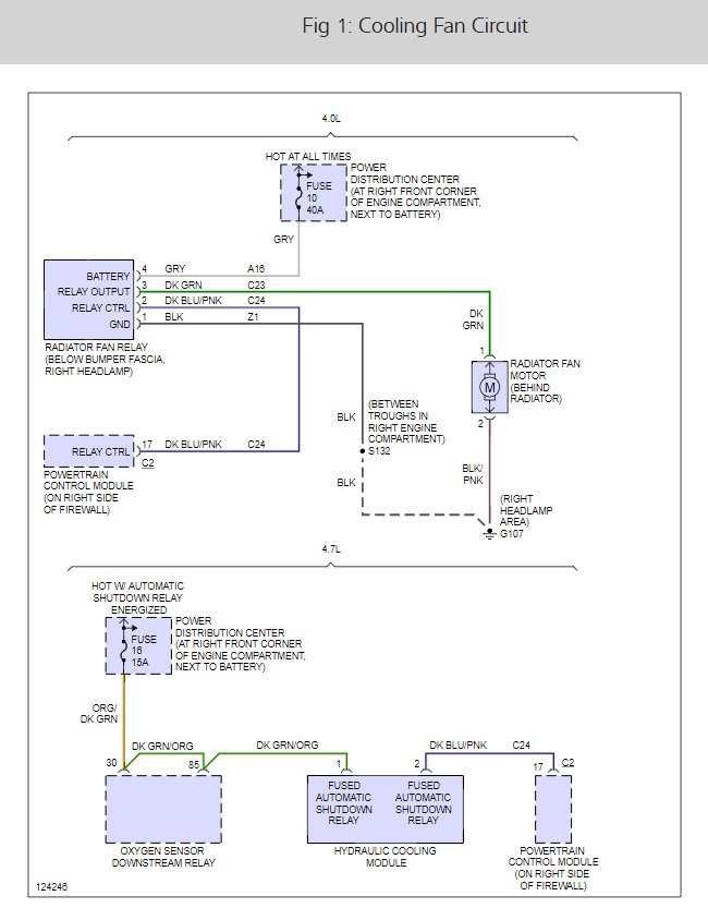

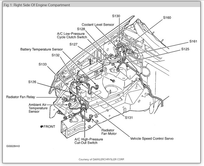

97 jeep cherokee country, 6cly, 4.0L, 100000, cooling fan keeps cycling, runs for 5 second shuts off, waits about 20 sec, runs 5 sec then off, is this normal operation? Temp. Indicates 195 deg. To 205
consistantly at idle.

Is it running with the AC comp
watch the clutch on the AC comp. If its cycling on and off
it may be low on AC gas 134A

the AC was off, I had the heater on. Should the fan on cycle be longer?

What really matters is what happens when you turn on the A/C? Does the fan stay on? Right now it seems to be controlling the temperature well!
Fan should run with a/c on. Other times it will cycle!

Just thought the fan was cycling too much on and off and only stayed on for 5 sec., Thought mayby some temp sensor was going or what ever controls the fan cycles. Sounds like the fast on cycles may be normal? What is normal ops for fan cycles with AC off?

Even so u have the heat on the AC COMP STILL CYCLE.S
CHECK THE CLUTCH ON THE FRONT OF THE COMP AND NOTICE IF ITS OPERATING WITH THE FAN
