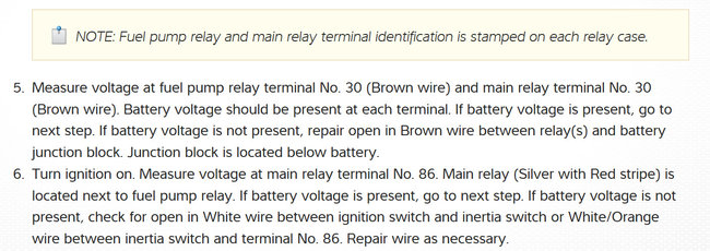

The car is not getting fuel. I sprayed starting fluid and it runs. Since then we have changed the fuel pump and fuel filter. Still same problem.

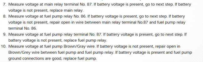

first thing is to put a gauge on fuel rail and check pressure could be wrong pump. should have 35-45 psi with key on only. if no pressure check for a blocked fuel filter then scan for codes if no ignition signal then pump may not work. check to see that inertia switch is not engaged andnot letting pump work it's on pass side foot well. check fuel pump relay see pics it is in trunk and should be marked in location check fuse in left fuse block D1
