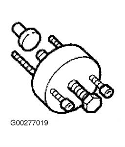

REAR DISC BRAKE PADS
WARNING:Brake dust, if inhaled can damage your health. Always remove brake dust using a vacuum brush. Do not use a compressed air line to disperse brake dust into the atmosphere.
NOTE:Special tools required: Brake Caliper Piston Retractor Tool (206-080) and Crankshaft Pulley/Damper Remover (303-588). See Fig. 68 and Fig. 69 .
http://www.2carpros.com/forum/automotive_pictures/266999_jag_90.jpg
http://www.2carpros.com/forum/automotive_pictures/266999_jag2_5.jpg
NOTE:Brake pads must always be replaced in axle sets.

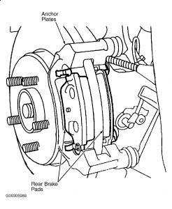

Remove and discard the rear brake caliper retaining bolts. See Fig. 62 . Remove the rear brake caliper and secure to one side.
Remove the rear brake pads. See Fig. 63 .

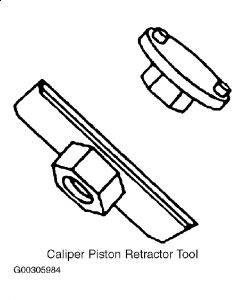

NOTE:The left rear brake caliper piston retracts counterclockwise and the right rear caliper piston retracts clockwise.
Using the Brake Caliper Piston Retractor Tool (206-080) and Crankshaft Pulley/Damper Remover (303-588), fully retract the rear brake caliper piston into the caliper housing. See Fig. 64 .
Install the rear brake pads. See Fig. 63 .
NOTE:Make sure the piston location mark is in the correct position so that the locator pin on the brake pad backing plate locates correctly into the piston.
