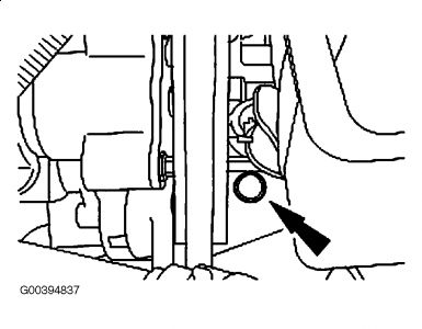

TRANSMISSION FLUID DRAIN & REFILL
Raise and support the vehicle.
Place a suitable container under the transmission drain plug.
NOTE:If an integral problem is suspected, drain the transmission fluid through a paper filter. A small amount of metal or friction particles may be found from normal wear. However, if excessive metal and friction particles are present, internal examination may be required.
Remove the transmission drain plug.
Install the transmission drain plug.
Tighten to 45 Nm.
Lower the vehicle.
Remove the automatic transmission fluid charging pipe cap.
Fig. 5: Identifying Transmission Fluid Charging Pipe Cap
Courtesy of JAGUAR CARS, INC.
http://www.2carpros.com/forum/automotive_pictures/266999_jag_71.jpg
NOTE:Use automatic transmission fluid WSS-M2C922-A1 or equivalent meeting Jaguar specification.
Fill the automatic transmission with 8 liters of automatic transmission fluid through the automatic transmission fluid charging pipe.
Carry out a TRANSMISSION FLUID LEVEL CHECK.
