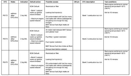

Codes P-0171 and P-0174

http://www.2carpros.com/forum/automotive_pictures/266999_jag_16.jpg
