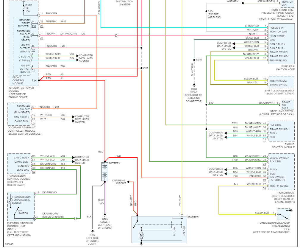

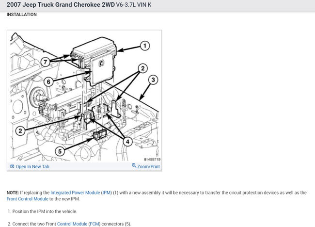

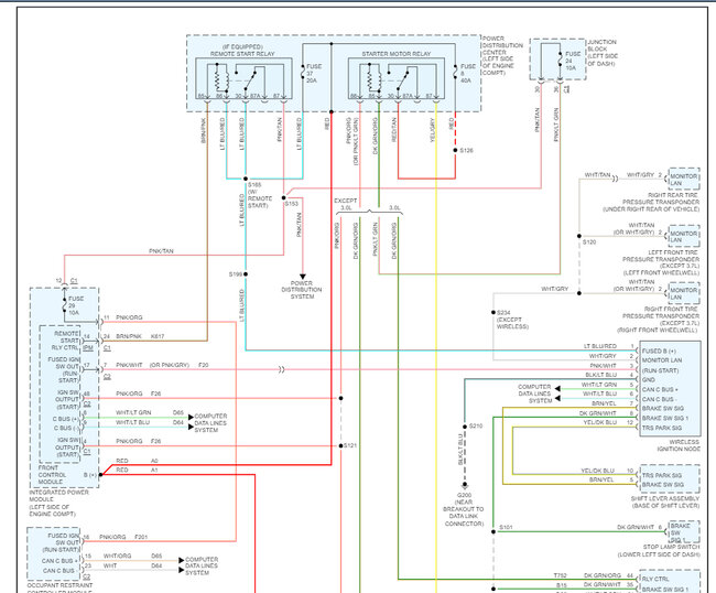

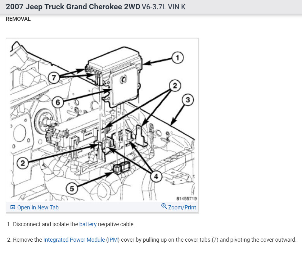

When I turn the key sometimes the car starts up fine. Then sometimes I turn the key and it’s continuous cranking even if l let go of the key.
I’ll drive somewhere then park, I’ll go attend business come back try to start up again and then it starts just cranking.
Note: sometimes I have to keep turning the key off and on to get it to start up.
May 2, 2023 at 9:58 PM
  • CAR REPAIR CONTRIBUTOR
  • 54,334 POSTS
Yep, this happens when the IPM goes out but to be sure we should do a CAN scan to see what comes up, you can get a CAN scanner (Controller Area Network) which will work on most cars from Amazon.
https://youtu.be/u-4syLc-ifQ
and

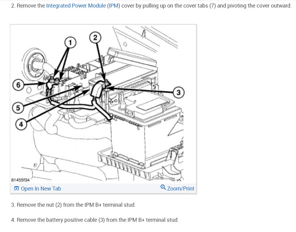

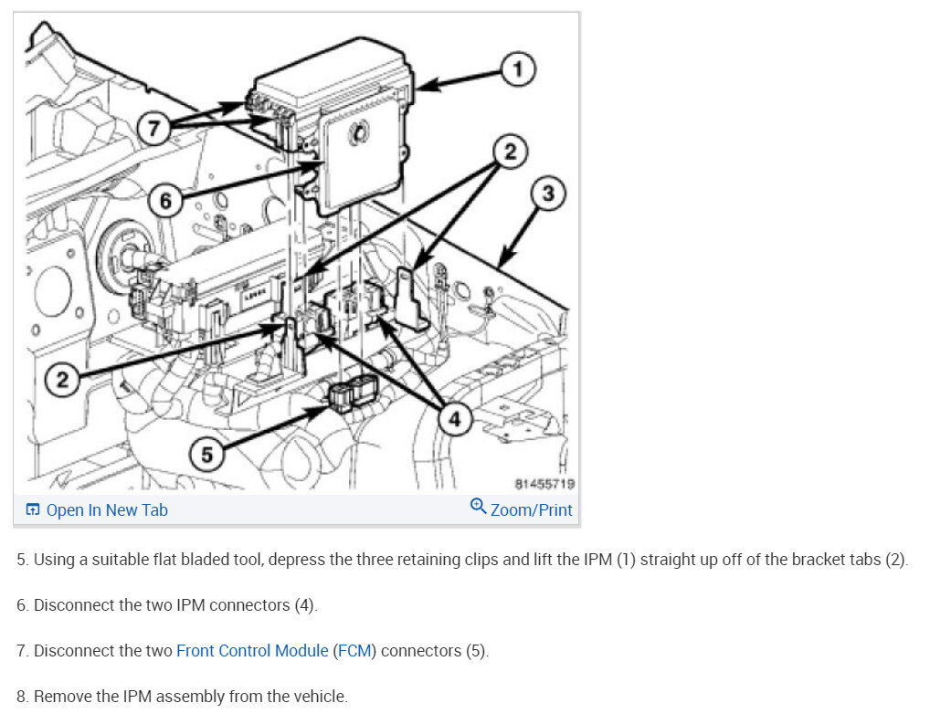

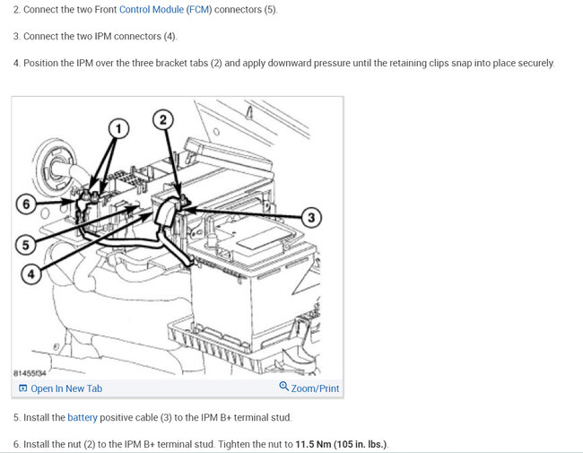

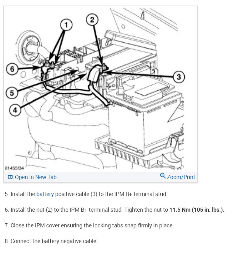

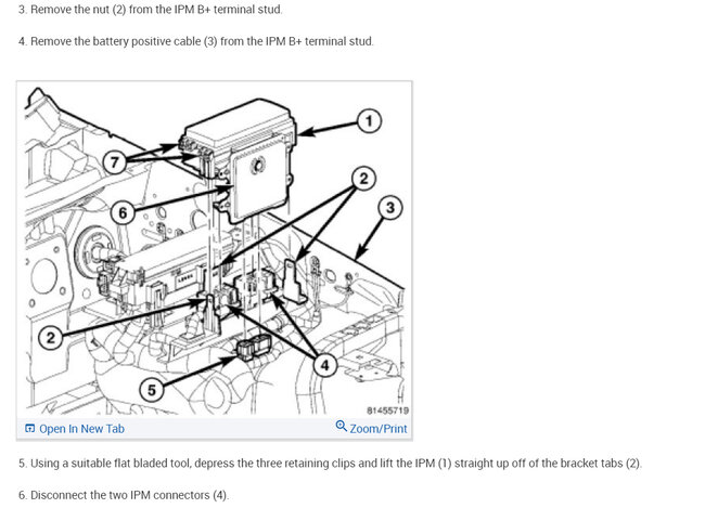

Here is how to change the IPM out and I have included the starter wiring diagrams so you can see how the system works. It is easy to replace because it-self learns. Check out the images (below). Please let us know what happens.
