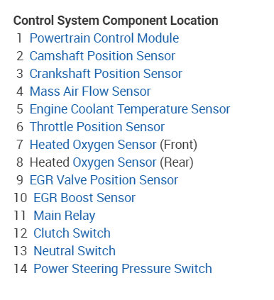

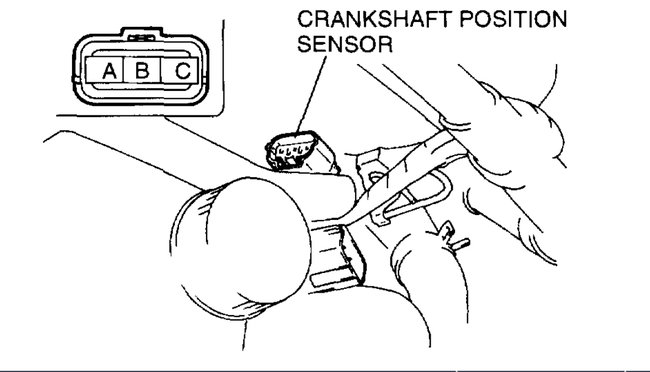

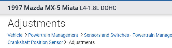

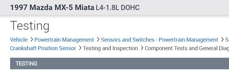

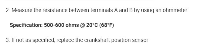

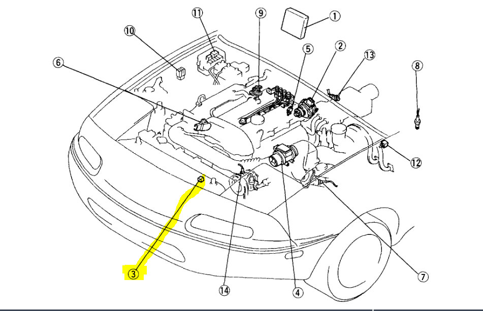

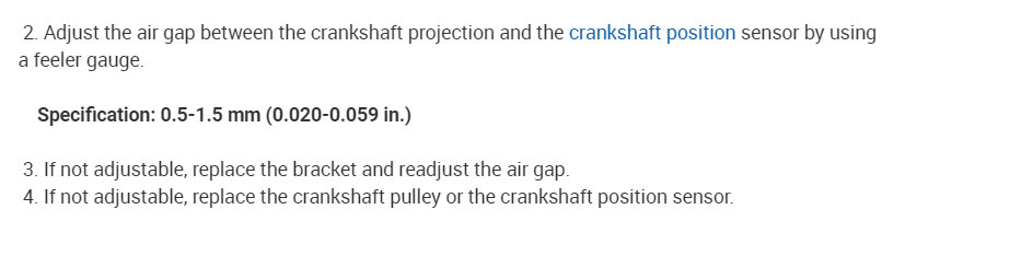

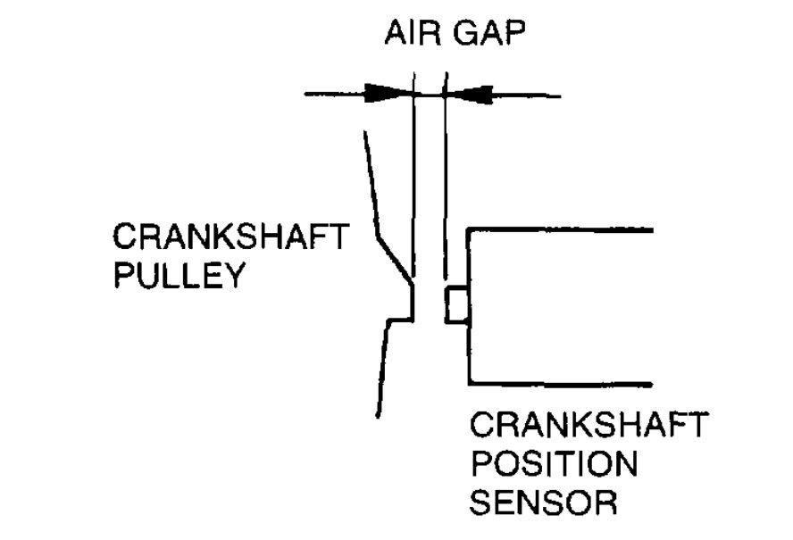

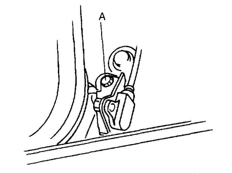

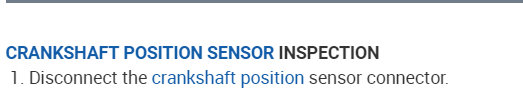

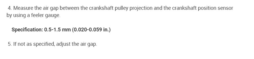

This could be a problem with your vehicle's Crankshaft Position Sensor(CKP). Your vehicle's CKP is responsible for sending a signal to your vehicle's Powertrain Control Module(PCM) giving it the rotational speed of the crankshaft. This is used for engine rpm's and for misfire monitoring. Without this signal the PCM will not know the engine is turning over and won't start it. In the diagrams down below I have included factory description and testing and adjustment procedure for your vehicle's CKP sensor. Please go through these guides and get back to us with what you are able to find out.
Thanks,
Alex
