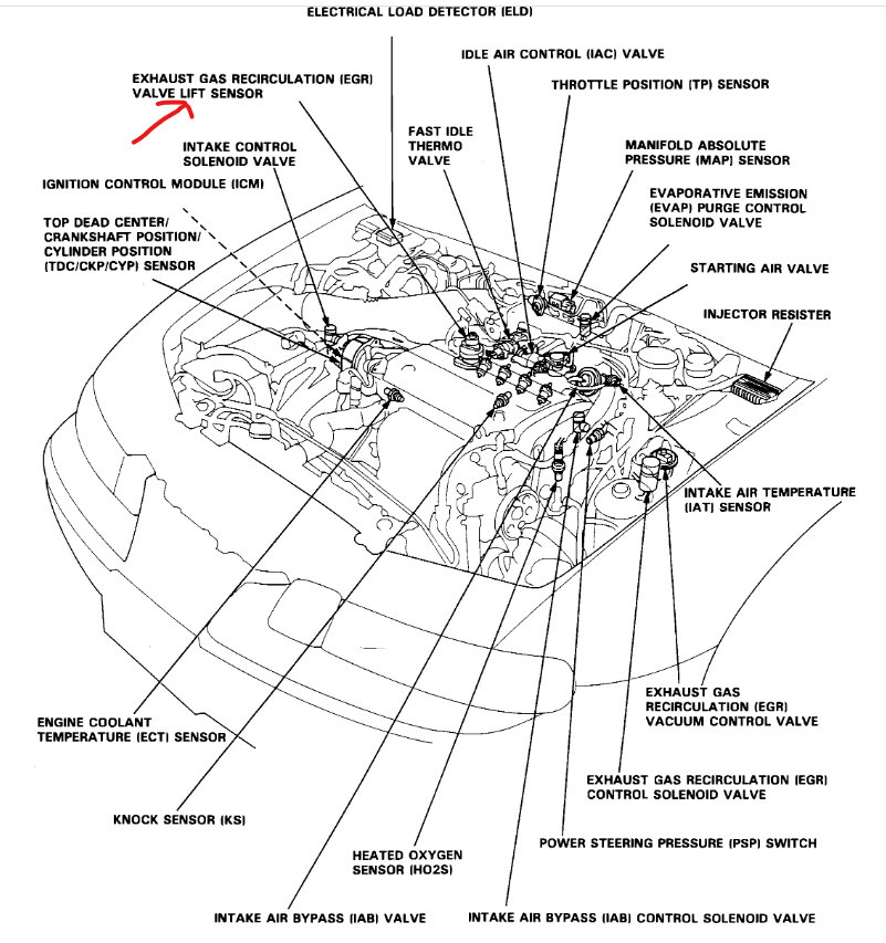

Idle is off and there is no pickup when I push the gas down
1993 HONDA PRELUDE
265,981 MILES • 4 CYL • FWD • MANUAL
OCTAVE
It's an h22-a1 Jdm crate engine and it's running rich in gas but no check engine light comes on it used to be super fast but now it's a slow car and the horsepower has gone somewhere else

check fuel pressure with a gauge, this guide can help
Please go over this guide and get back to us.

I would remove the EGR valve to see if i is stuck open here is a video to help you test it and the location of the valve in the images below.
https://youtu.be/DqUCbbKdWf4?si=ld6CkeSzoC5k-DHN
