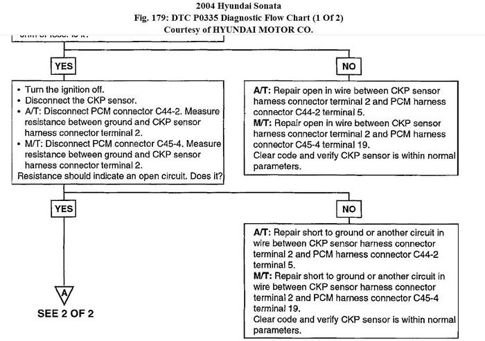

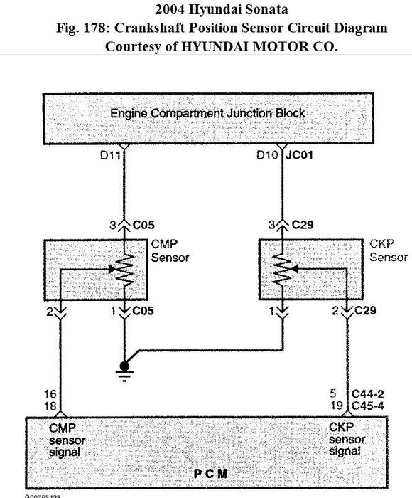

Autozone said "crank shaft positioning sensor"was bad. Replaced it. Replaced long timing belt but did not touch small belt as it was "pristine". Made absolutely sure ALL timing marks aligned before and after installing belt. No spark.
Code reader says cam/crank shaft sensor failure. Failure at line "a". Failure Pending. (Code is P0335) Have tried deleting code to no effect. Engine turns over just fine, but I have no spark at either coil pack. What do you suggest?

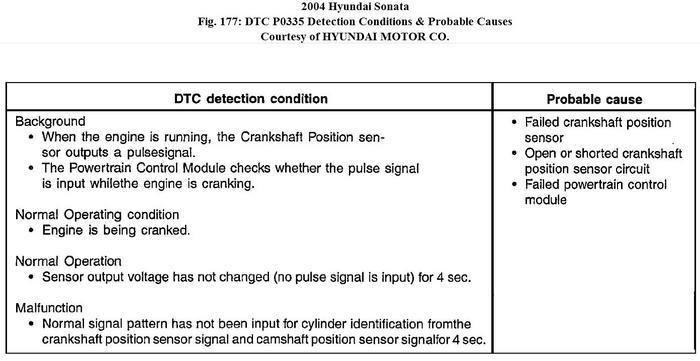

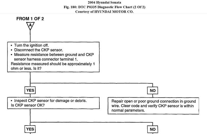

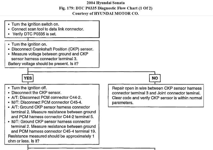

KHLOW2008
  • 41,815 POSTS
P0335 is for the cranksensor. Cam sensor needs the engine to be cranked for a certain time and speed before it would register.
Refer to the following charts to see if you can come up with anything.
+2
Friday, January 13th, 2012 AT 3:08 PM

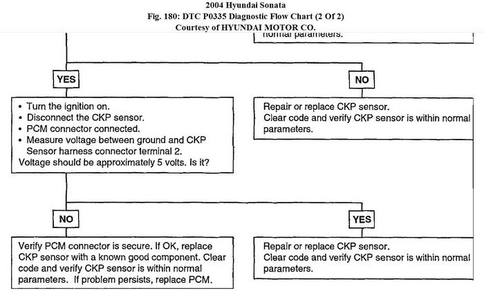

LEDIY99
  • 7 POSTS
OK, Now "we" are getting somewhere! The pages you included allowed me to determine that there IS voltage to the sensor. In the process I DID figure out how to "test/read" the sensor while it is still on the vehicle. I'm tempted to say how I accomplished that (for a fee!) But that would be mean. All I had to do was take a wire from the positive battery terminal to the "top" pin on the plug (red wire). Then read the return voltage on the lower right pin (black wire). Both the old and new sensors read about 10+ volts returning. Come Monday we are going to tow it to a local shop and put it on their machine.

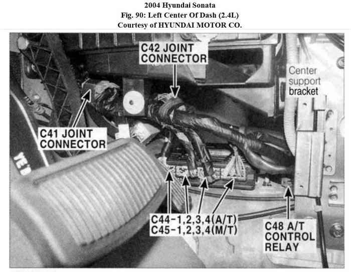

Figure 180 says to measure resistance between ground and CKP terminal #1. I read MORE than 1 ohm, 2. Something. Is that OK? Then it says to measure voltage between ground and CKP terminal #2. I got 4.68volts. Is that OK?
The only test I couldn't do was the "A/T:Disconnect PCM connector C44-2" as none of the paper work I have available to me told me WHERE that plug was.
I have learned a couple of things while working on this problem. 1) I will NOT work on another late model car without access to the Factory Shop Manual for that vehicle right from the start. 2)I will (most likely) NOT take the diagnosis from a Code reader as "fact".

KHLOW2008
  • 41,815 POSTS
Refer to diagram for connector. It is behind lower center of dash.
Saturday, January 14th, 2012 AT 4:47 PM
LEDIY99
  • 7 POSTS
KHLow2008, The diagrams you included did help some. Eventually I got some help via another site. In the end I did find "the problem". This is quite embarrasing to admit, but it seems that when I was trying different ways to dress the wiring to ensure it didn't rub on the timming belt (there is PRECIOUS LITTLE CLEARANCE) I accidentally installed the sensor 180 degress out of position. That is to say Backwards! The plate was passing Behind the sensor rather than through the slot! No wonder the engine wouldn't start! If I worked on cars for a living I wouldn't forgive myself, but I was "coming out of retirement" to help a friend who is about broke. After the engine started I heard a "pop" and then noticed a Bright spark at the ignition wire to the #1 cyl. We replaced 2 ingition wires and that helped the idle. Would have replaced the coil packs but at $80 each that will have to wait. He desperately needs to repair the half shafts and 4 tires. BUT WAIT, now the Starter has taken a dump! He has no money for that and I can't loan him any more than I have already. "If it weren't for bad luck."
In total I used 4 web sites in an effort to get help. 3 were "free", 1 asked for a $2 donation (this site?) And 1 charged me $36. The first 4 were of little to marginal help. The last one was totally useless. Should I find myself doing any more work on late model cars I will insist that the owner get me the FACTORY SHOP MANUAL. My mechanical skills are acctually quite good despite this disasster. But having the manual would have made all the difference. I still have over 30 manuals I collected over the years including the one for the 1962 Rambler Classic Stationwagon I learned to drive in! Time was I knew the average life expectancy of most parts on popular vehicles from the early 60's to mid 70's. Knowing the milage told me a lot. Looking at the engine, smelling the engine added to that and listening to it crank and fire up told me everything I needed to know. I could take a car (say a 60 something 283 cu in Chevy)that hadn't run right in years and restore it to "tire chirping status" with a full tune-up, carb. And valve adjust. Got a call one time to fix a Nova that had dontated it's original 327 for a latter model 350. It didn't idle right. First thing I did was verify the firing order. 1, 8, 4, 3, 6, 5, 7, 2.9. NINE? What the? Seems that the #8 wire from the distributor was dangling behind the engine while the wire from the #8 cyl. Was laying on the intake manifold. That would do it! So I'm not the only one who makes silly mistakes!

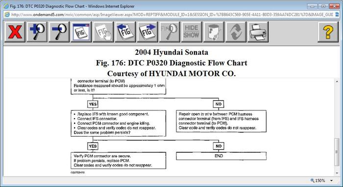

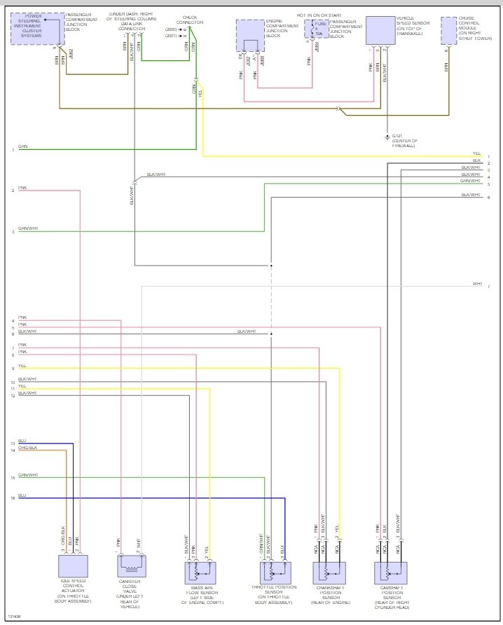

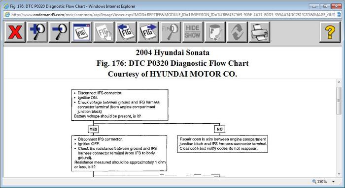

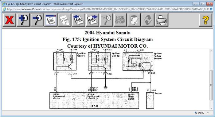

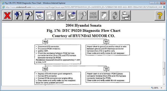

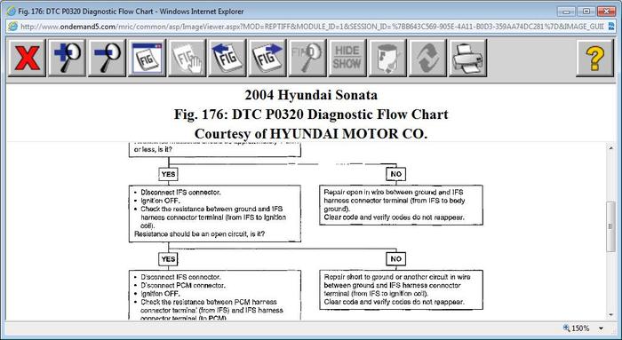

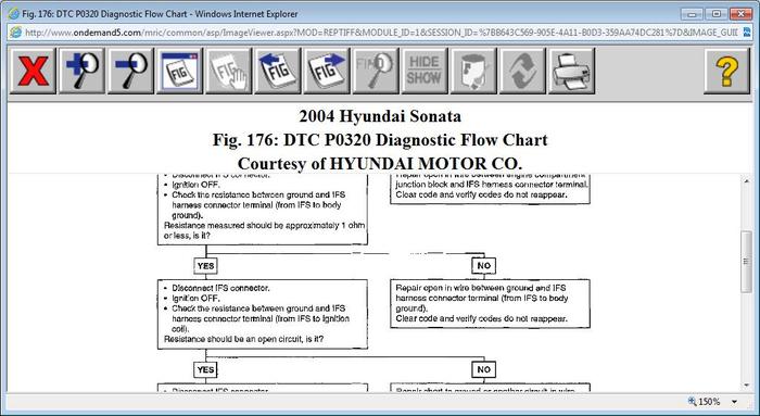

Ive changed cps+cam senser +plugs=coil pack+air flow metor+electric module that sends power to coil connectors 3 pin and I keep getting fault code p0320
i changed another coil pack today still no spark but the coil pack over heating and a big bulge on side of coil pack and was red hot ive changed so mutch things what could be the problem I cant find a short anywhare? And it looks like a short to ground; please any help app thanks
+1

SATURNTECH9
  • 30,870 POSTS
What size engine do you have?
Tuesday, May 2nd, 2017 AT 10:01 AM (Merged)
THIS IS MIKE
  • 686 POSTS
2.0L ENGINE 4 CYLINDER
-1
SATURNTECH9
  • 30,870 POSTS
I posted the wire diagram and the trouble tree for code P0320 follow it and let me know what you find. Please post all replies on this question.
