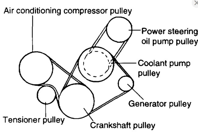

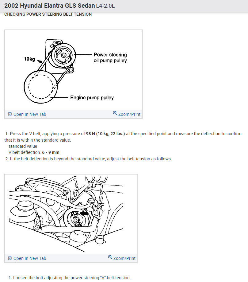

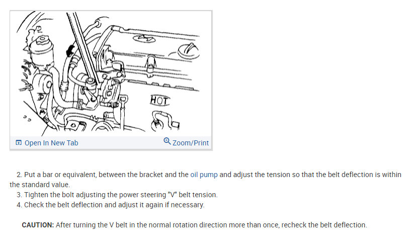

The squealing sound it likely the belt. As the serpentine belt gets old the rubber in the belt can glaze and when that happens the belt will loose traction and will slip during startup or when it's cold. It will make that squealing noise.
Here is a helpful article:
https://www.2carpros.com/articles/car-squeaking-noise
