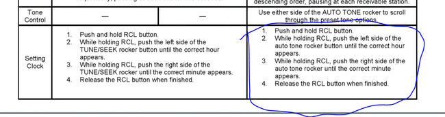

Need to set the correct time on deck display. When I looked for YouTube videos all the videos were not a 6 CD changer it was a regular Saturn CD player. This Vue is a 6 CD changer from Saturn. The videos from YouTube stated to press and hold the RCL button and change with the seek button but that doesn't work on this Saturn 6 CD changer.

I was able to find directions for this system. See pic 1. Let me know if that takes care of it. In the manual, it is showing the 6 CD changer. These are the directions which go with it.
Note: The directions on the right that I circled are listed under this system.
Let me know if it works.
