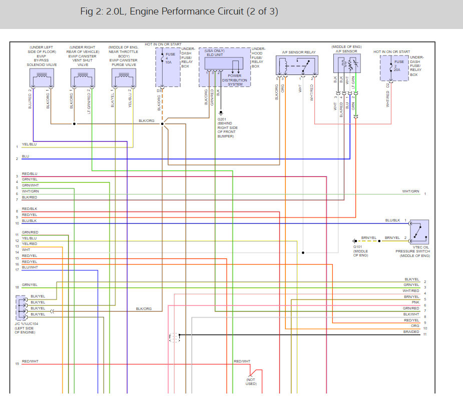

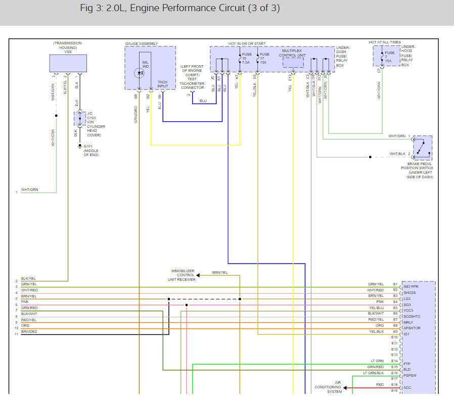

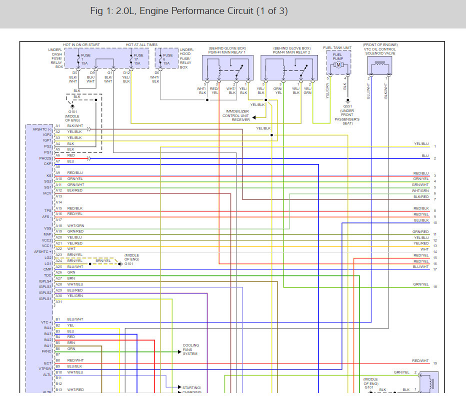

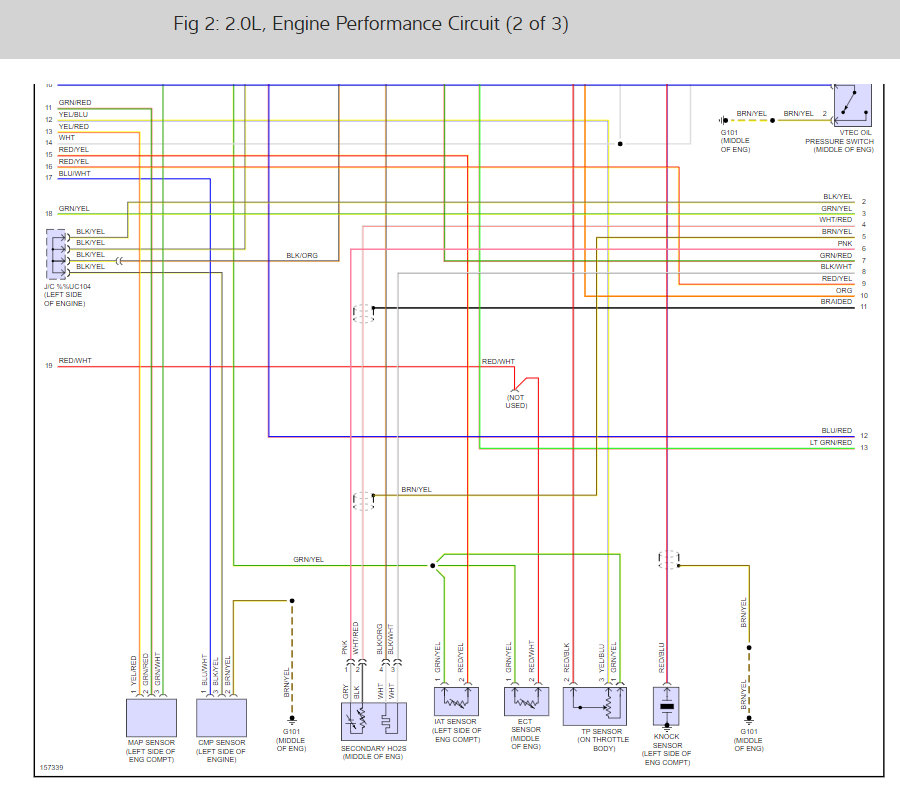

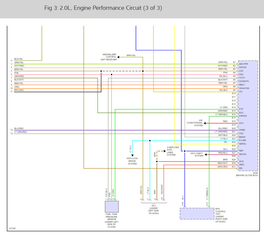

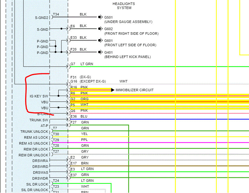

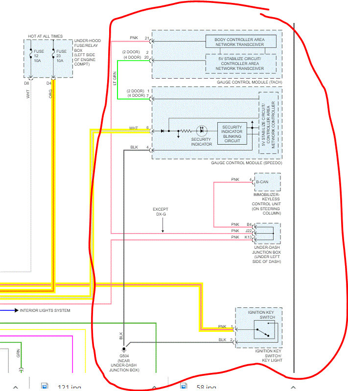

Just got the ignition re-keyed and programmed as well as a new battery. The car cranks and runs but the security light flashes, hazards flash (no horn) and the car refuses to go over 35 mph. What can I do to reset this without having to go to dealer?
Saturday, August 8th, 2020 AT 11:06 AM (Merged)
  • 108,117 POSTS
Since the security light is flashing, my first question is if the reprogramming of the key was done correctly. That light should be off if the car recognizes the key. Have you spoken to the person who did it for you?
Next, what really needs done is to have the computer scanned to identify diagnostic trouble codes specific to the anti theft. Here is a video that shows how it is done:
https://youtu.be/b2IJGfImVvw
I realize most people don't own a scanner, but often times a parts store will do it free of charge. Often times they will either rent or lend one to you if the vehicle isn't running or safe to drive.
I mention having it scanned because there could be many things causing this to happen. There really isn't a reset or anything like that other than if it is done with a scan tool capable of communicating with the vehicle's computers.
I mentioned if it was done correctly because there are many things that can be causing the problem. Not trying to be confusing, but if you look at the two pics I attached, you will see only a few things that control the anti theft. Without a diagnostic trouble code, it becomes a guessing game and I wouldn't want you to replace parts that are good. In all honesty, my first suspect is it needs reprogrammed.
Please feel free to ask questions.
BABY2016
There is not green key icon showing in the dash as to where the key doesn't match. That's what is confusing me. It also cranks and runs (but only up to 35 mph).
  • 108,117 POSTS
A green key is what you need. Did this just happen since the key was replaced?
BABY2016
Yes, the car ran before it was parked and key was lost.

  • 108,117 POSTS
I hate to say it, but it needs reprogrammed to recognize the new key. Have you spoken to the person that did the work the first time?
