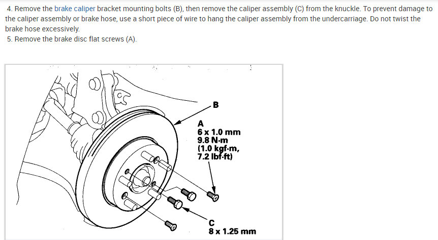

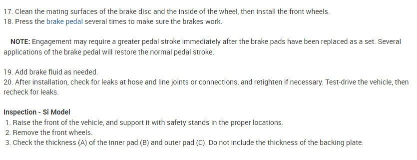

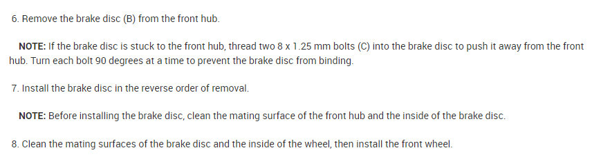

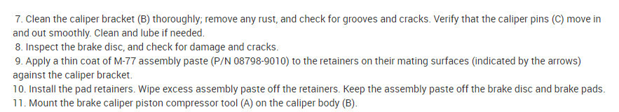

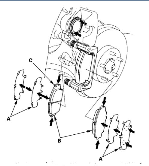

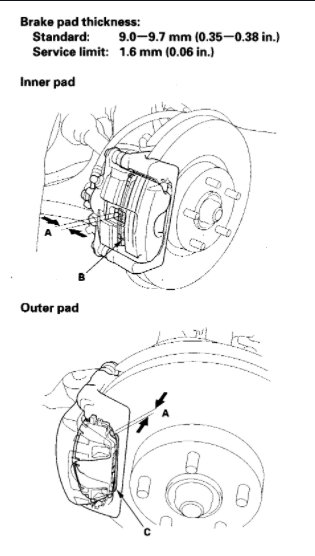

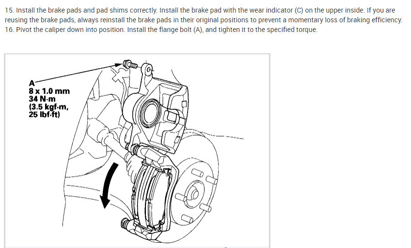

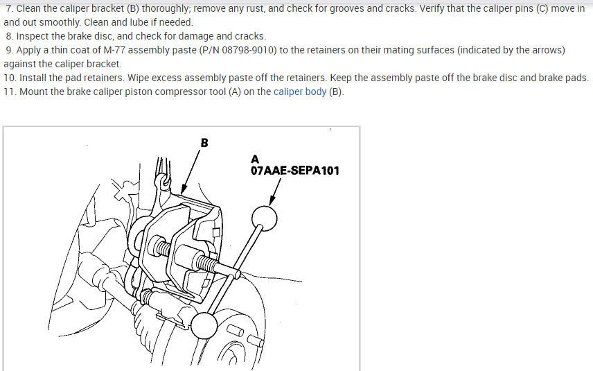

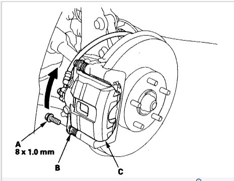

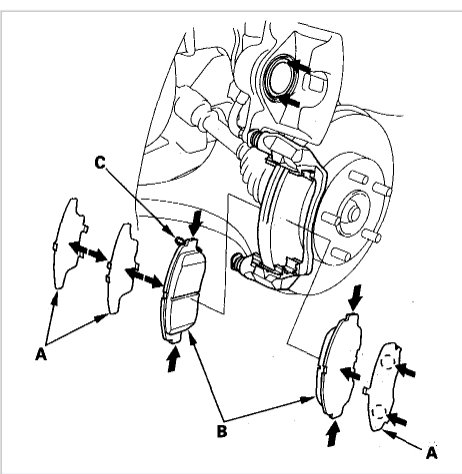

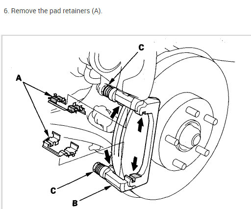

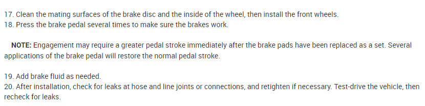

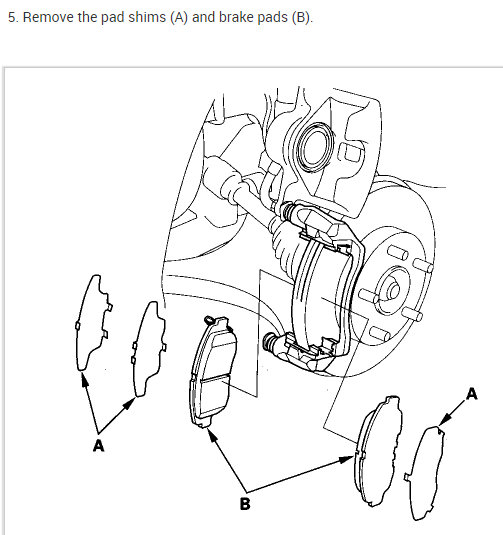

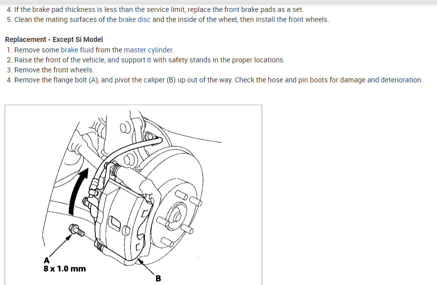

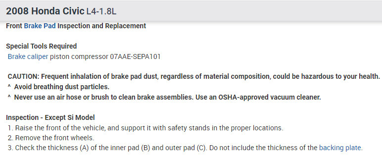

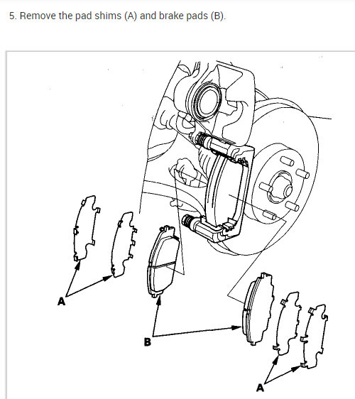

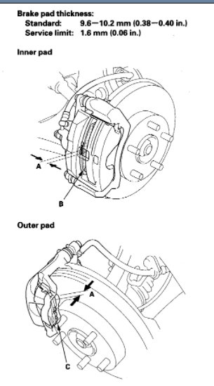

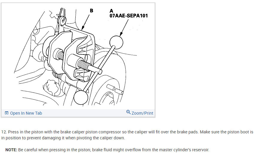

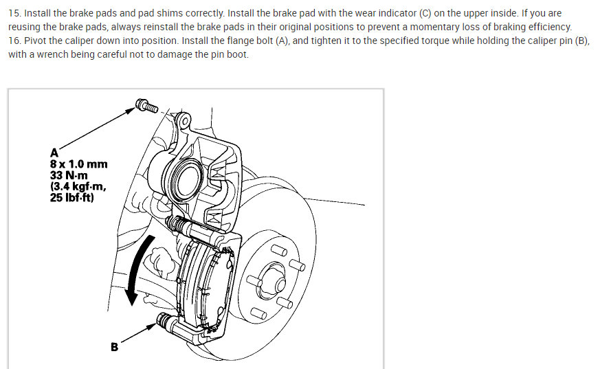

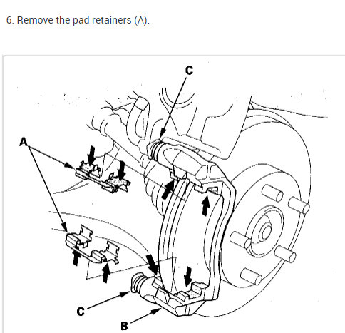

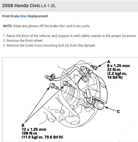

I recently hit a curb and it made a dent in front of my car then my brake warning light came on so I need to do a brake job.
Do you
have the same problem?
Monday, May 26th, 2008 AT 4:18 AM
DANNY L
EXPERT
Hello, I'm Danny.
Here is the information you requested. This is a tutorial showing what is involved on how to change front brake pads and brake rotors.
I've attached picture steps below on how to change the front brake pads and rotors on your car. Hope this helps and thanks for using 2CarPros.
