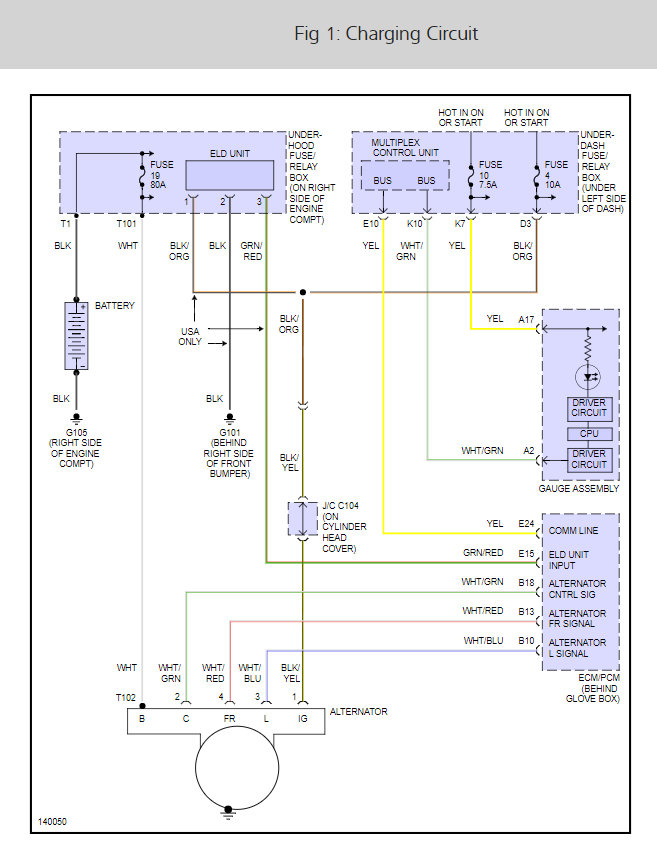

I already got a new battery and alternator installed plus a new Electronic Load Detector (ELD) but the battery light stills stays on. Everything is good and charging, its just that light wont turn off. Can someone point me out in the right direction before I tear up the wiring from the alternator to the fuse panel under the dash, to the computer and finally to the indicator light in the dashboard? Thanks in advance.

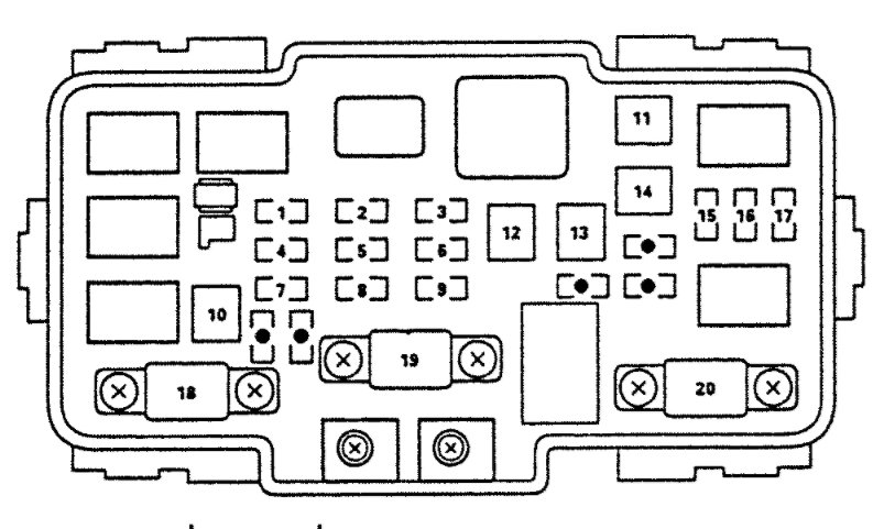

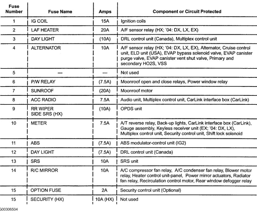

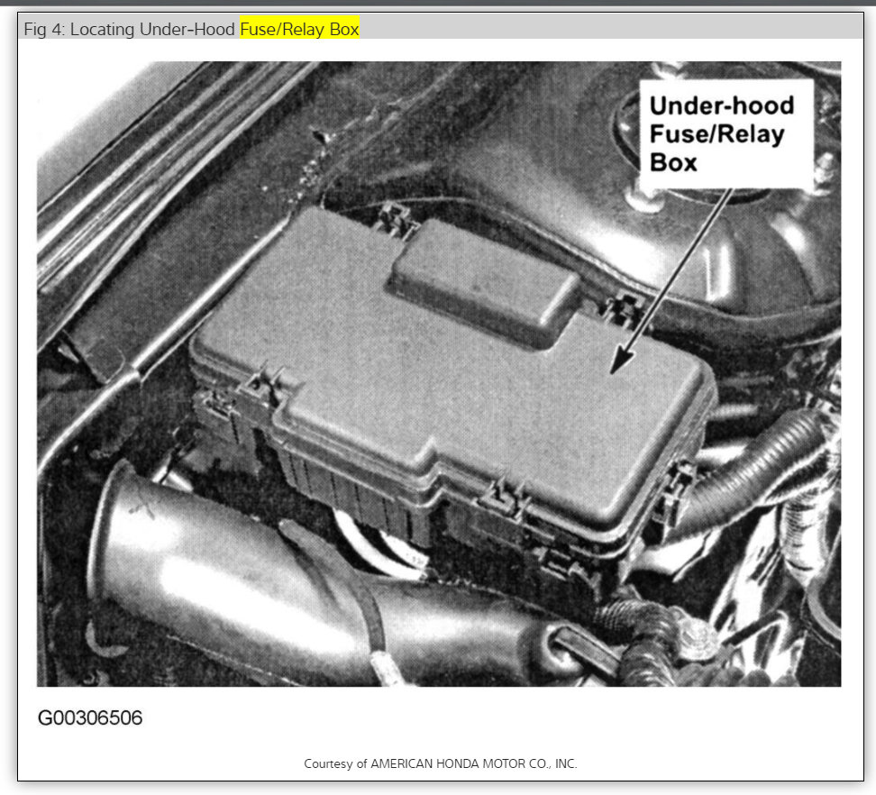

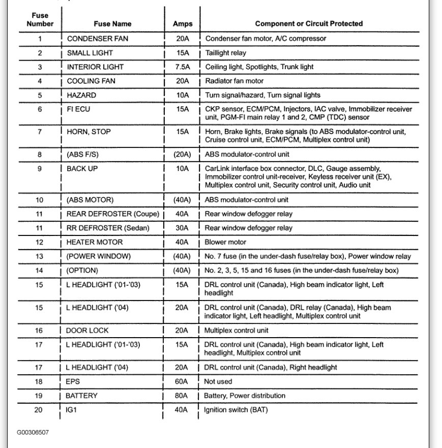

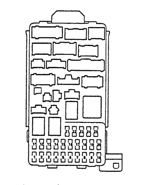

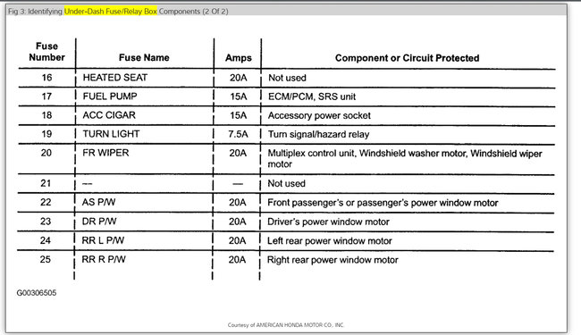

There are some wiring connections that need to be confirmed. Here is a guide to help you do some testing along with a alternator wiring diagrams so help you see how the system is connected.
There is also three fuses that run the systems as well.
