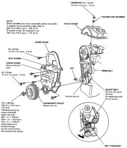

Timing Belt Illustrated Index
NOTE:
*Before removing, mark direction of rotation.
*Refer procedure for positioning crank and pulley before installing timing belt.
*When installing the new crankshaft and/or new bolt, tighten the crankshaft pulley bolt to: 200 Nm (20.0 kg-m, 145 lb-ft), loosen it, then retighten to: 165 Nm (16.5 kg-m, 119 lb-ft)

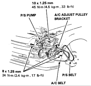

2.Remove the power steering pump (standard for some types).
3.Remove the A/C compressor adjust pulley with bracket and the belt (standard for some types).

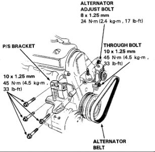

4.Remove the power steering bracket.
5.Loosen the alternator adjust bolt and through bolt, then remove the belt.
6.After installation, adjust the tension of each belt.

8.Remove the valve cover.
9.Remove the special bolt, then remove crankshaft pulley.
NOTE: When installing the new crankshaft and/or new bolt; tighten the crankshaft pulley bolt to: 200 Nm (20.0 kg-m, 145 lb-ft), loosen it, then retighten to: 165 Nm (16.5 kg-m, 119 lb-ft)
10.Remove the timing belt upper cover and the lower cover.
11.Loosen the adjust bolt, then remove the timing belt.
12.Install in the reverse order of removal; adjust the valve timing.
13.Carry out timing belt tension adjustment.
