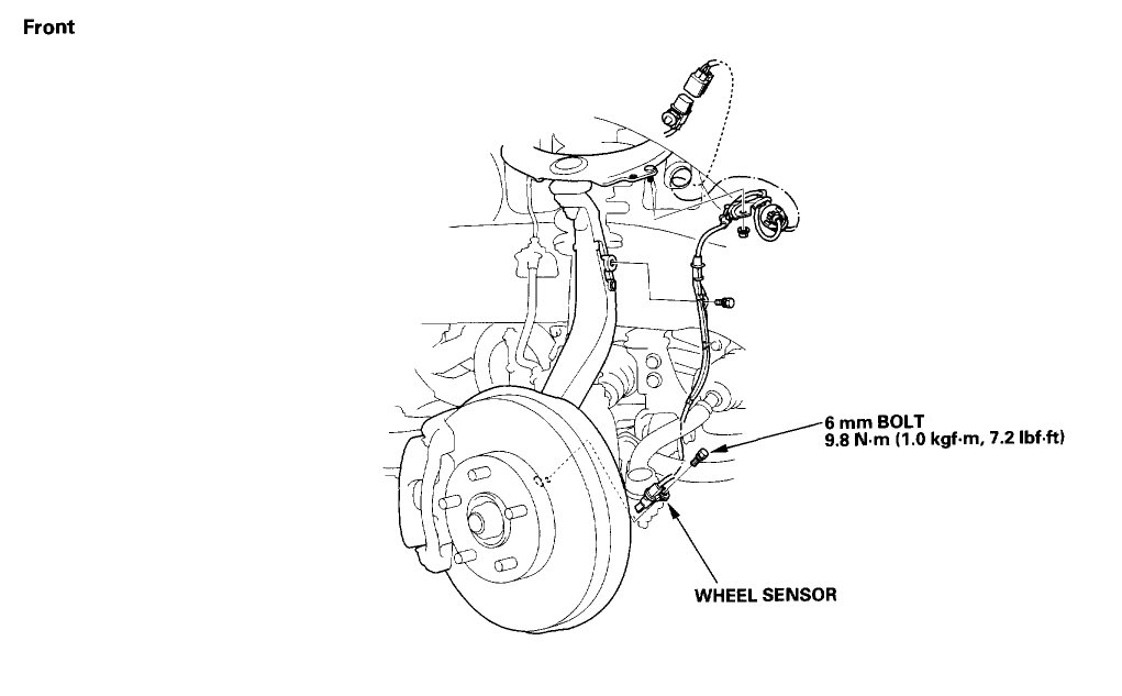

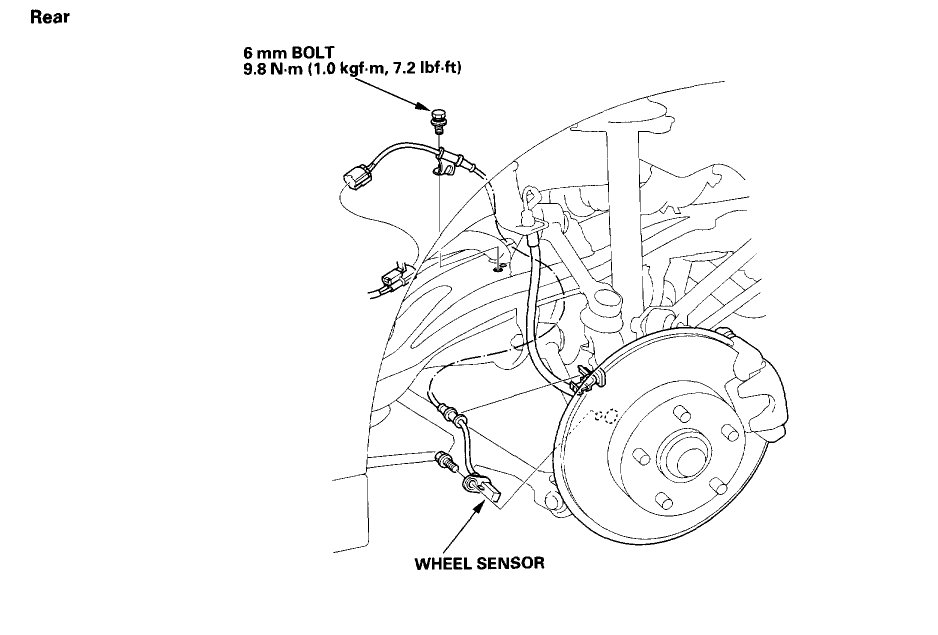

DEVERS
TCS light is on. Car is a 2003 honda accord v6
Jun 20, 2020 at 12:45 PM (Merged)
  • CAR REPAIR CONTRIBUTOR
  • 54,334 POSTS
The is for your traction control system its telling you the system is not working and that you have an error. It is probably a sensor fault. Here is a way to test each sensor so you don't need a scanner to fix the problem.
https://www.2carpros.com/articles/abs-wheel-speed-sensor-test
Here is a video to show you how to check for codes
https://youtu.be/rTtAnsOlZU4
This will give you the wheel speed sensor that has failed.
Check out the diagrams (Below). Please let us know what you find.
