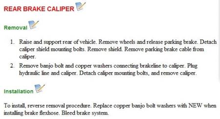

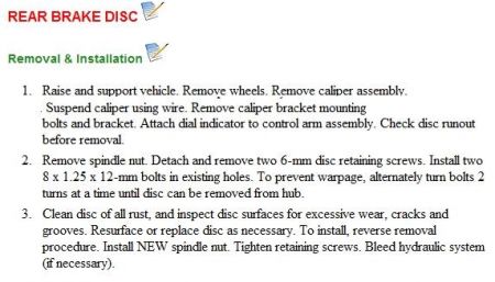

How do I replace my rotors and do I need any special tools
Do you
have the same problem?
Thursday, March 25th, 2010 AT 6:35 PM
BLUELIGHTNIN6
  • EXPERT
Hello and thanks for donating
below are the replacement steps for your vehicle's rear rotors and you do not need any specialty tools for this repair..
http://www.2carpros.com/forum/automotive_pictures/261618_Noname_1909.jpg
http://www.2carpros.com/forum/automotive_pictures/261618_Noname2_612.jpg
