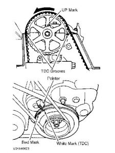

The #1 Cylinder has to be at TDC
Here are the markings...
http://www.2carpros.com/forum/automotive_pictures/188069_91accord2_1.jpg
