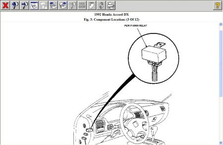

Hi smileysgirl1,
When the eigine cuts off, does the dash indicator lights shows? If no, then the ignition switch is faulty.
If you have a fuel supply problem, the item that you should check is the PGM-FI main relay. It is known to intermittently fails causing stalling and non starting.
http://www.2carpros.com/forum/automotive_pictures/192750_PGMFIRelay92Accord_10.jpg
