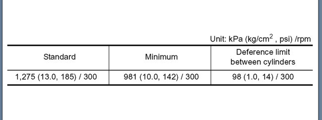

If the engine actually overheated, then we need to start with checking the head gasket and the compression.
I suspect we have an issue with the head warping or the coolant and oil mixing. So here are a couple of guides that will get us started:
https://www.2carpros.com/articles/coolantantifreeze-in-the-engine-oil
Once we know what the compression is we will be able to figure out the next steps. So, let's start with this and we can go from there.
