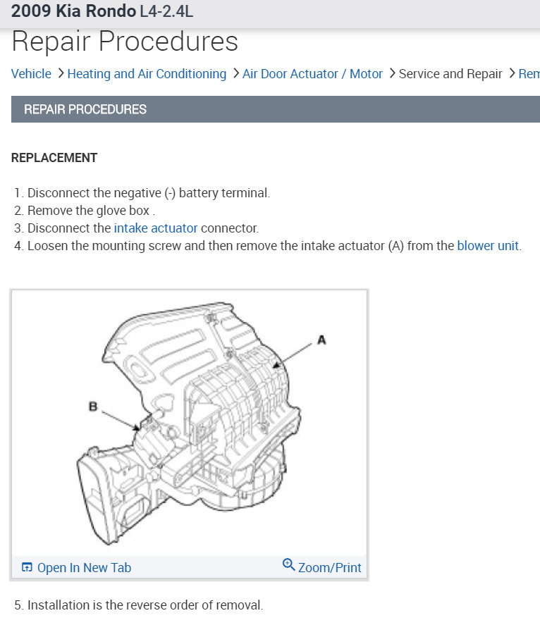

During cold temperatures (outside) once car is started the heat will only blow from its current location. Example: controls set to dash and I set them to defrost, air continues to keep blowing from the dash. Heat will also not work, but air is blowing. After a few minutes I can turn the car off and then everything starts working correctly. Sometimes it takes driving it a few minutes then it will either start working or I will need to turn the car off and start it back up to get it to start working. Mechanics so far say that they can’t get it to replicate the issue, but I think they think that the heat is just not working and don’t understand. The heat works fine, just takes a few minutes for it to work and for the controls to start working. Any suggestions?
Oct 20, 2019 at 5:32 PM
  • CAR REPAIR CONTRIBUTOR
  • 54,334 POSTS

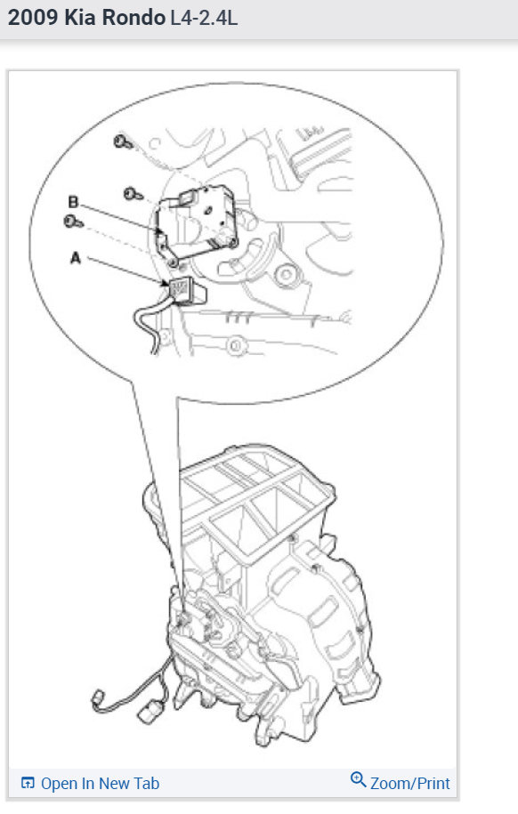

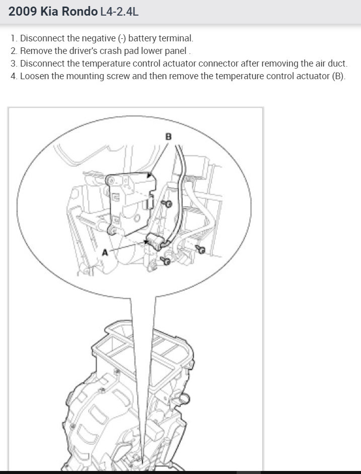

It sounds like the mode blend door actuator is going out. here is the location of all the blend door actuators so you can see how the system works and which actuator to replace with a guide to help walk you through the repair:
