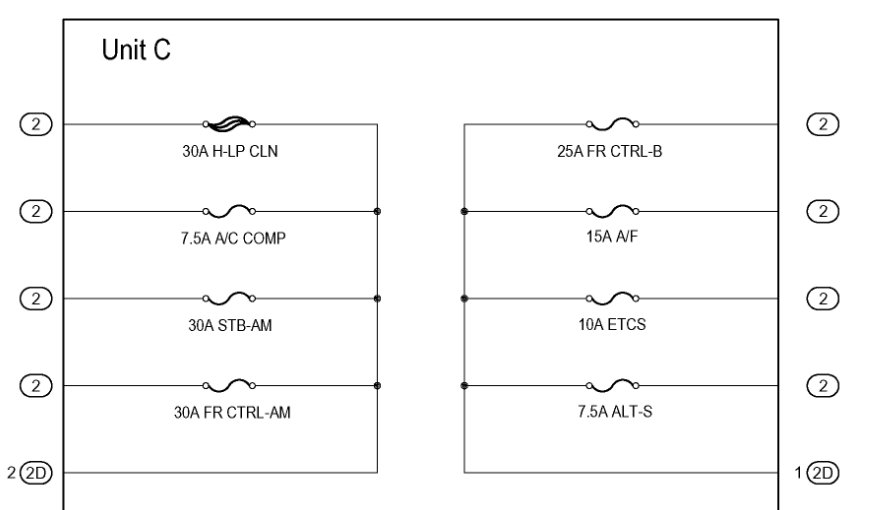

I just bought the car last week and I was told it only needed a blower so I had one installed. heat only comes from the defrost and for most of the time it is colder on driver side while the passenger side is normal. the weird thing is if I put the A/C on it blows somewhat out of the front vents not one hundred percent but a lot more than the heat! I should also mention that I had to change the battery and when I did that it tripped something and the alarm would not shut off had to have Lexus change the door actuator.

They did not want to give me a guess they wanted $185.00 an hour to take apart dash to test the actuators they estimated three hours to do it. I refused.

The actuators could definitely be the issue. if the doors are not changing as commanded, this will result.
try this. remove the fuse for the HVAC system and wait ten minutes. then reinstall the fuse and turn the key to the on position. wait one minute before starting. that calibrates the actuators and see if that made any difference.

In the fuse diagram there is about five that air conditioning do you know which one?
Apr 9, 2018 at 6:14 AM
  • CAR REPAIR CONTRIBUTOR
Okay, diagram attached. the ETCS.
