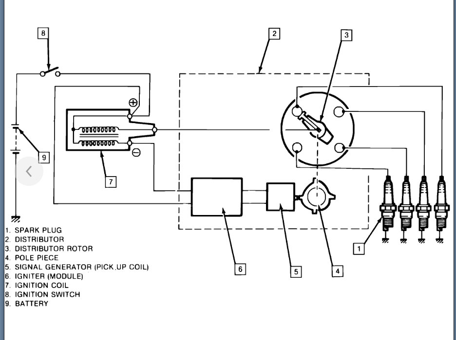

Here is a system description for the ignition that will help get us on the same page of how this works. Let me know how you testing for spark and we can go from there. Thanks

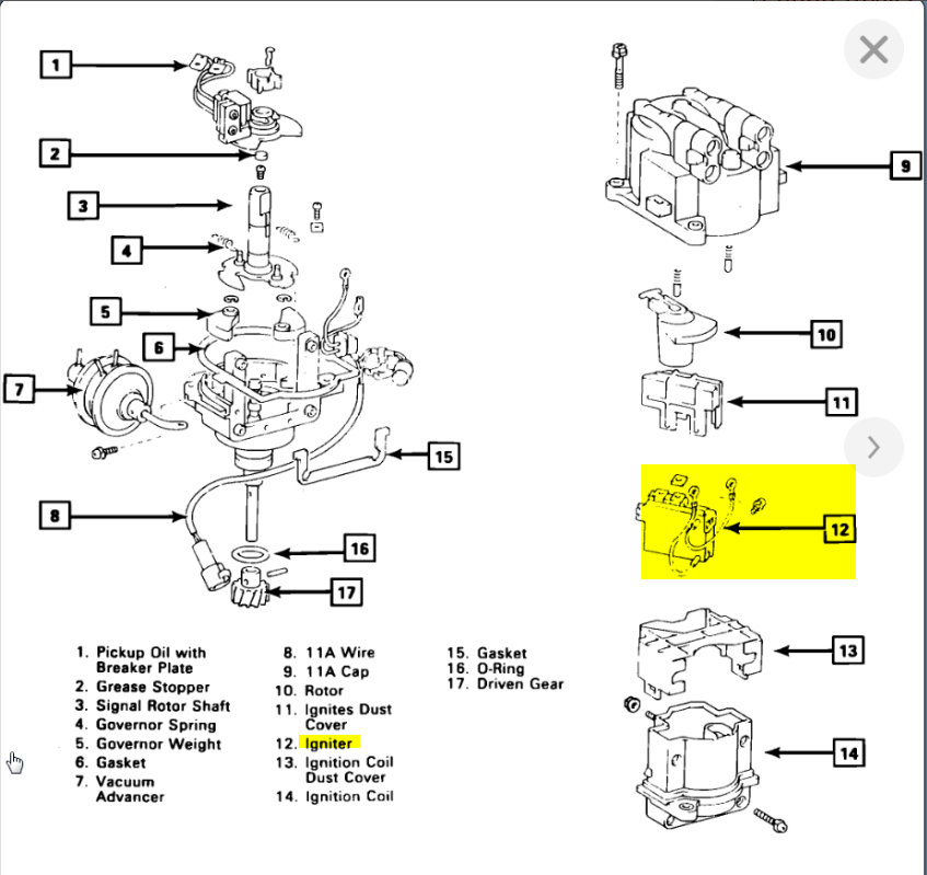

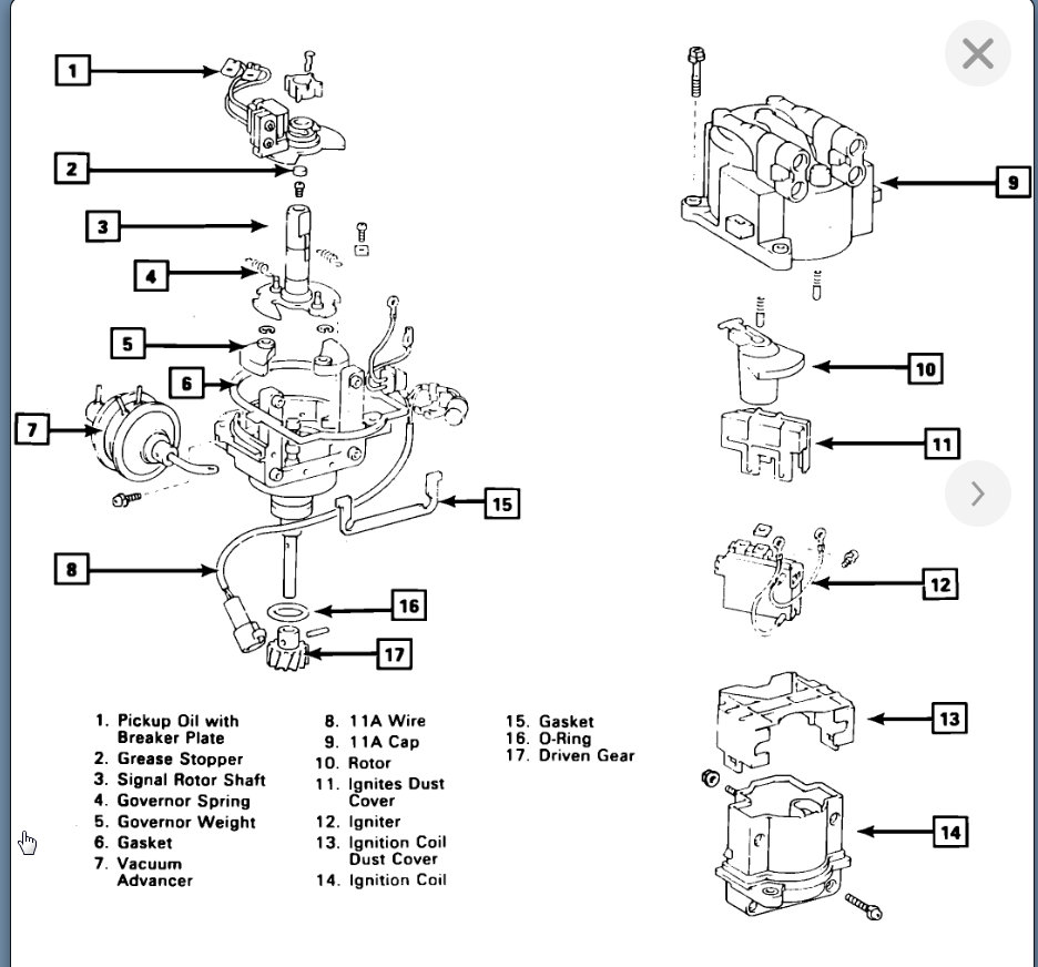

This could be the coil but if you are not getting the strong spark the most likely cause of weak spark is the igniter. This is the component that interrupts the primary spark to create the high voltage for the secondary spark (the bright blue spark). If he is going to replace the coil, he is right there to replace the igniter at the same time.
