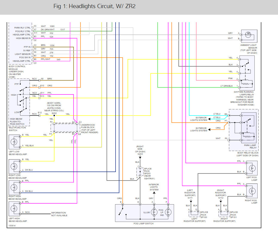

my headlights on my driver side of my truck are very dim and they work good on the other side But what i am wondering is y my high and low beams on the drivers side is on but very dim. The bulbs are burning but don't but out any light. i do have a wig-wag box hooked up to it due to being a vol. firefighter but i have replaced it and check my wires for it and they are probably done. so what is the problem and can please advise me how to fix it thank you

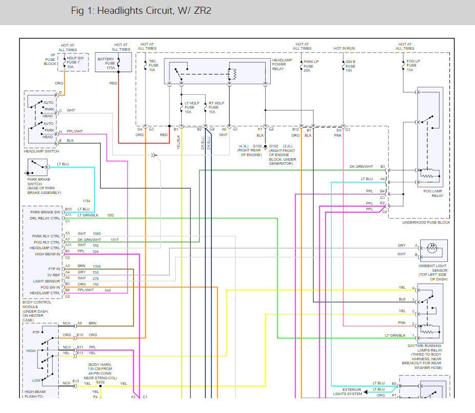

You need to find the under hood fuse relay box and check the 15 amp fuse for the side that is bad. There is a fuse for the left headlight and one for the right headlight and when on goes bad that side will dim. Left is drivers and right is passenger side. Let me know what you find. Also leets check the system grounds. Here is a guide and the headlight wiring diagrams so you can see how it works.

I had to fix the ground near the battery works great!
